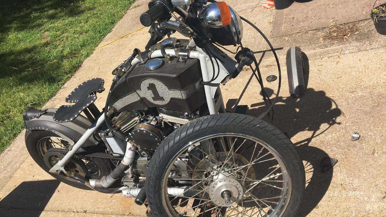

Hi,
I built a bike with help from the “Chopper Handbook” community back in 2006. I’d just like to say that the bike is still on the road. You may remember it as it was the cover bike for “The Horse, Backstreet Choppers” April 2007.
I moved to the south Nashville area a few years ago and had the bike in storage for a while. Big mistake. The heat from storage messed up a lot of things. I’ve had to replace seals, electronics, rebuild brakes, carb and a lot of other things. The leather survived, though and I’m slowly working it back to original condition as I hop on it and ride quite frequently now.
If anybody wants to help me tune up the Keihen Carb, much appreciated.

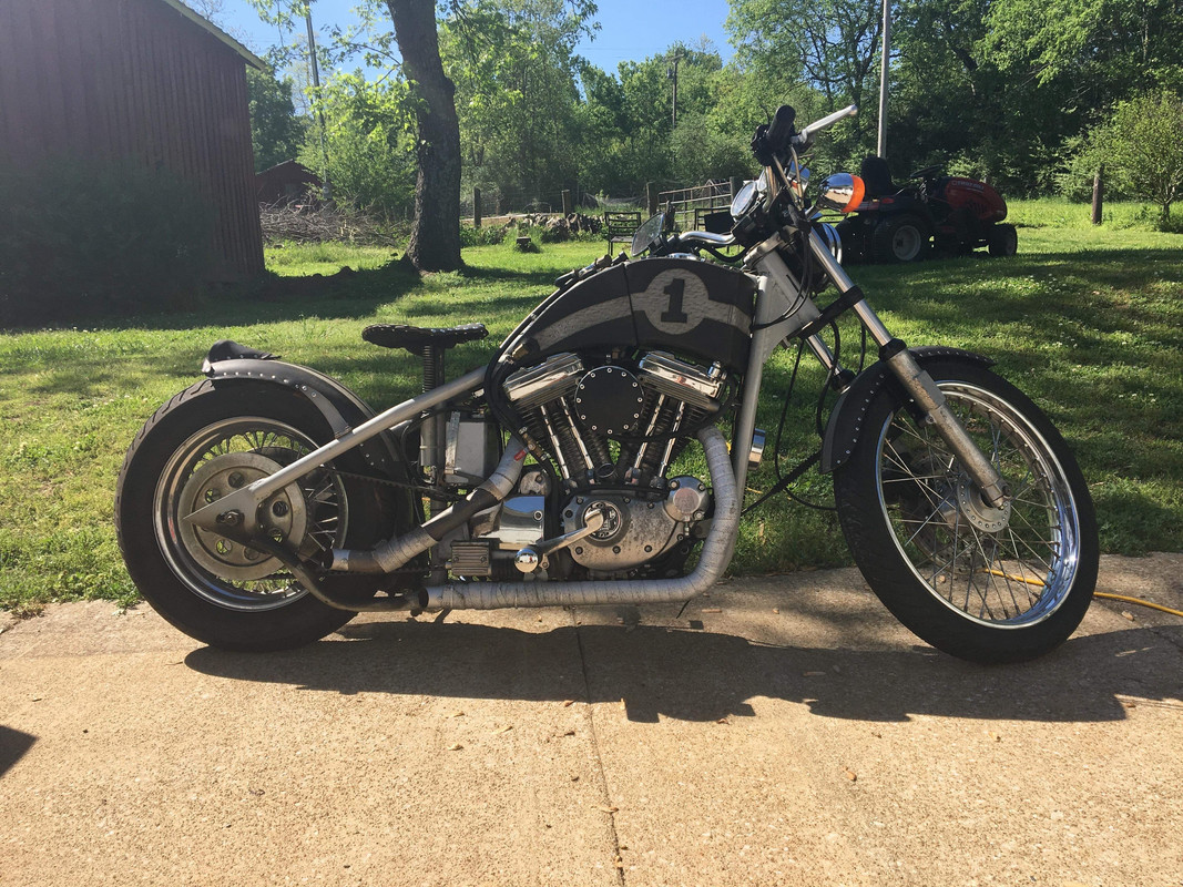

The one major design flaw to date is that oil tends to flow into the crank case from the elevated oil tanks if the bike sits too long without running. When it cranks it wants to throw oil out the breather tube. Fixed that with an in-line valve leaving the oil tank. The seat design has worked great. Have put about 10,000 miles on it so far win no comfort issues.

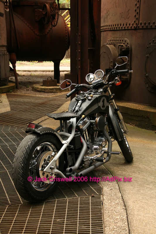

I had to swap out the engine overnight when I rode to the Smokeout back in 2007 April. The transmission splined shaft stripped out and a replacement took two weeks to arrive. Pulled the engine out of my 100th Anniversary bike to make the trip. Not sure if anyone noticed at the Smokeout. You can tell if you look at the official pics.

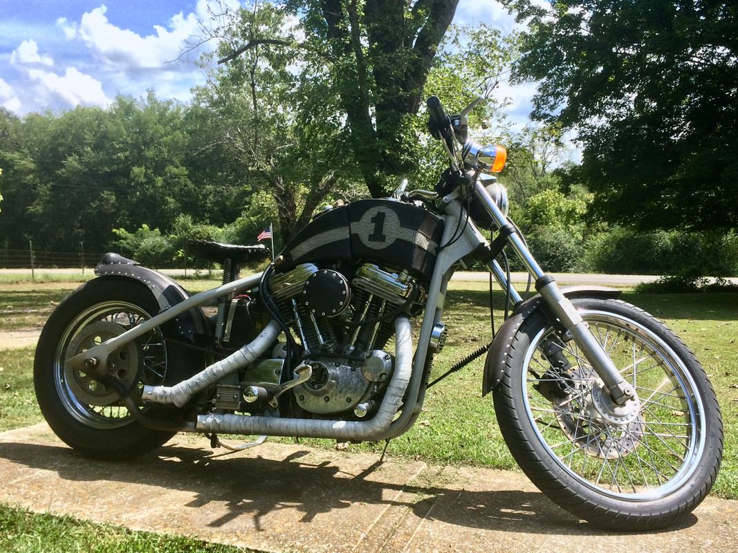

If you look at my bike pics you will notice that the front forks are a bit too tall. When I hit the road bump a while back, apparently, that ruptured the seal in my right fork. I rebuilt the carb last week and took the bike out for a ride only to discover fork fluid leaking out of the fork.
I looked up the parts and ordered a kit from JPCYCLES. I finally decided to lower the front end while I had the forks off to change the seals and fluid. I finished the lowering and seal replacement last night and will put the forks back on this evening. I’ll post some “After” pics to show the difference. I also videoed the work for YouTube because I could not find a video for that year range Sportster (84-87) online.
