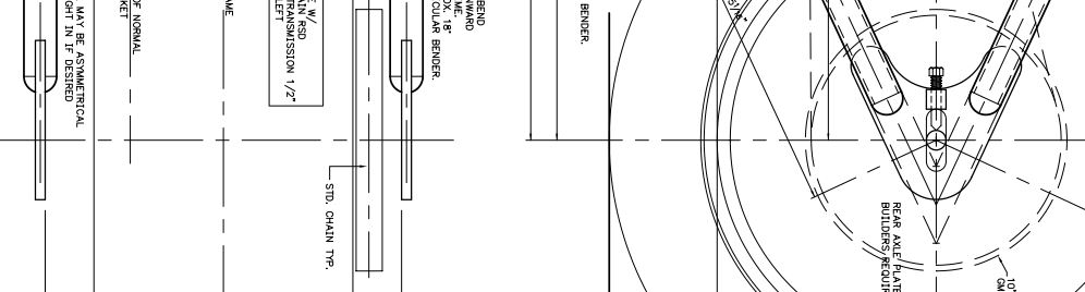

Drawing looks amazing. That should help a few guys out there.

I have tried to find diemension for the carrier have you had any luck??
I really do not want to post/release the drawing and have several mad bikers looking for me because that diemension is off and they ruined $$$$$$ in aluminum billet!!!

Probably best to leave that dimension off till we figure out a way to get it...nothing worse than pissed off bikers hahaha.

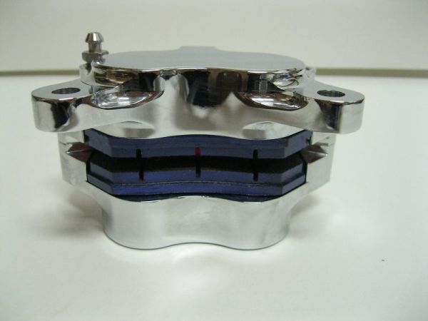

Little change of plans and decided to go with this caliper. Will end up being cleaner looking.
Jireh cycles 90-814 Ultima chrome 4 piston caliper

What did the caliper cost???
Why would the other not work??
By looking at your housing/carrier housing the right side in print steps down after the bolt length??
Is that true or am Iseeing it wrong?
You get those diemensions if the case and I will add them!!

Caliper cost 115.00 new with pads...the other I was going to use would of been 35.00 plus 27.00 for pads and been flat black. So I went with this one...other would just need a different mount made up.
Good eye on the step down...I didn't even catch it. Its merely cosmetic though, the important part is for the carrier to fit. I didn't even remember doing that but its only for the eye appeal.

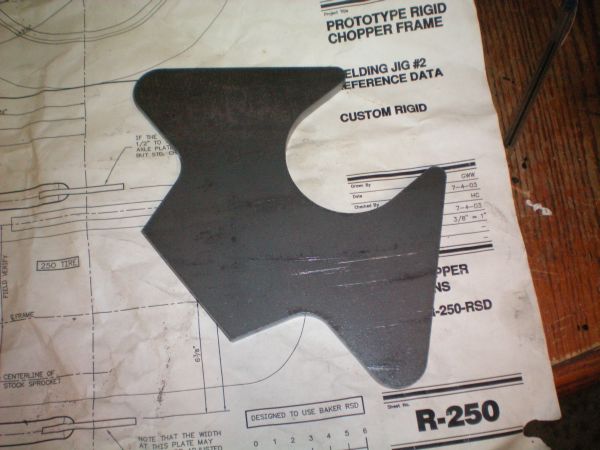

Got the cut files for the steel bracket back from a fellow member here. Thanks Wendell
Hopefully they will be cut this week. Also got the caliper in and will be making up the mounting bracket this coming week.

Here is what I have so far for the carrier drawing if you would like to share with your friend as he does good work and is sure to improve on it!!
Maybe we can get the drawing finalized and looking professional???
https://www.dropbox.com/s/hz42faspnt3an ... arrier.dwg
If you could and he does improve it can I get the dwg Cad file link to it!! PLEASE!!!

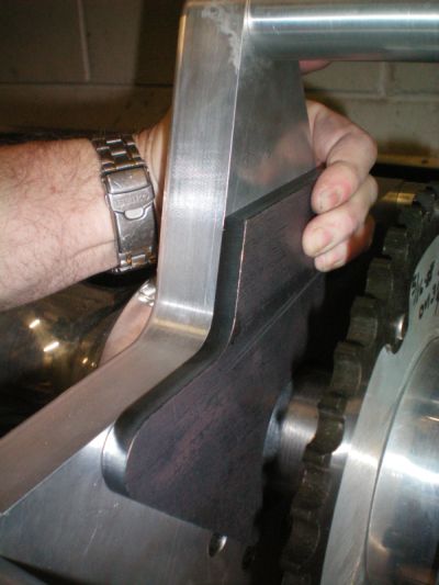

few more things on the go....

Thanks for the great details.
Do you bolt it on right here , or further forward?

Hiya Hans,
Nope not a bolt on...this would require either modifications to an existing frame or in my case I will build a frame to work with this. That part will probably be a 2014 thing though
