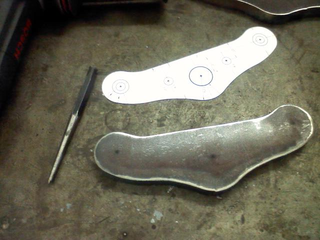

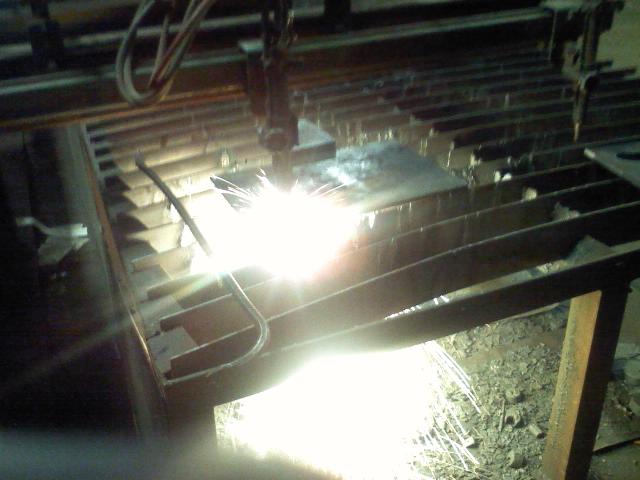

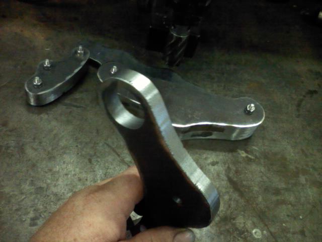

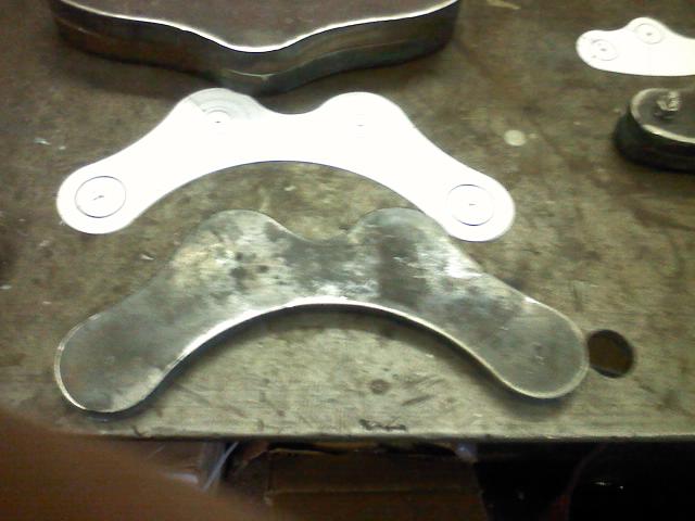

im about 3/4 done building my springer but now that were on the new bord ill try and get things caught up ill start with pics from the other bord then catch up as soon as i can i got progress on all my builds and started another too

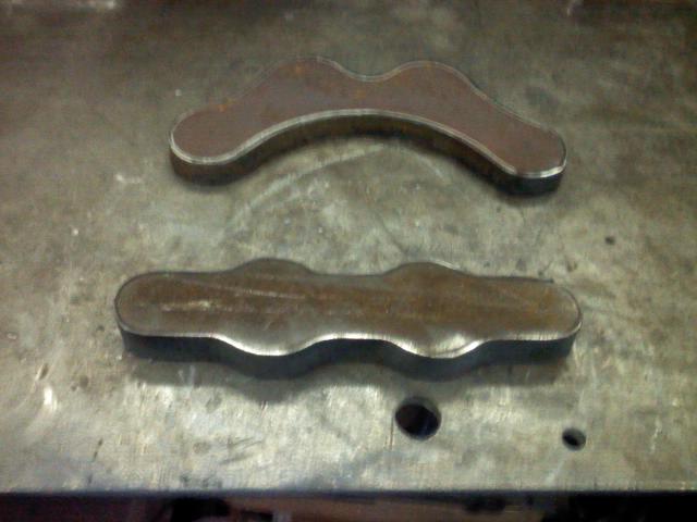

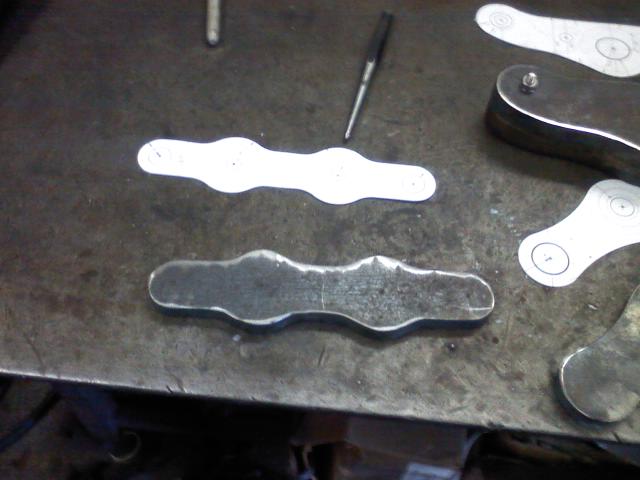

i dont know how many pics it will let me load at once so sorry for the choppieness

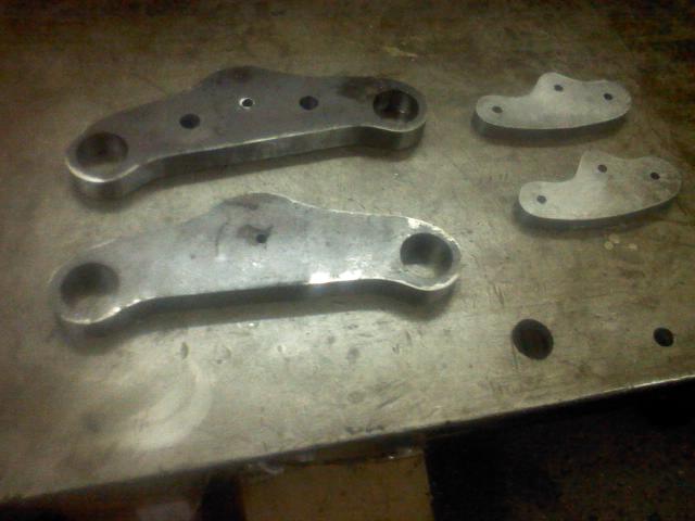

ok took me some time to track down the wheels i want to use had to settle for a fat boy rear but ill change it out later for a spoke wheel got the rear on and had to make a stand for the front because i dont have a tire yet but i know the height when the tire is on because its the same as the one on my dyna . got the frame proped up where i want it to sit at when im rideing it measured and cut the rear legs i fishmouthed the tubes and welded on the ends for the rockers . now that i got them done i gotta get outa work early enough to hit my friends shop hes got a much bigger lathe so i can fit the tubs through the chuck and square them up and make shure theyre exactly the same length . hoping i can get free tomorrow .i got my springs and rods and all the hardware for those took some time to figure out the reamer (thanks dan for the help while going through all the nightmare of the old bord and new and your knuck ) it turns out its a taper pin reamer number 8 and if ya drill the hole 7/16 it saves a lot of reaming . once i got the first hole done and knew what size the hole was i stuck drillbits down the hole till the bigest one fit through the small end and drilled the other hole with it then it was a very light ream just had to put the taper in it and a lil more gotta b carefull . then i put the springs together i made a tool to do it it was real easy to make from scrap ill post some pics tomorro left work so i could try and make my friends shop before he left didnt make it oh well tomorrows another day

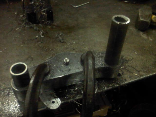

forgot i also made the stem i found a 1 inch bar in the scrap pile that had no rust on it yet turned down the threads on the lathe picked up the nuts for the bearing and tree from j&p cycles from the partnumbers on the plan welded it to the bottom tree droped in the bearings and bolted it together for a trial fit the holes were perfect the sholders fit perfect cant wait to start welding it up
