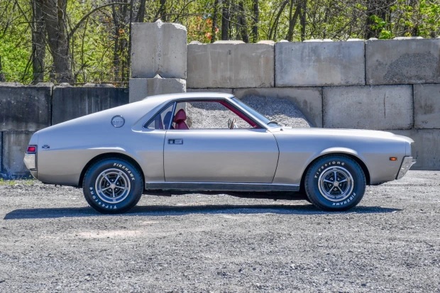

Driving from Philly to TX next week.
Re: Road trip! 👍👍👍
Posted: Thu Sep 01, 2022 2:57 pm
by railroad bob
Planning to run north end of Blue Ridge Parkway, Whhels Thru Time Museum, Tail of the Dragon during trip
Re: Road trip! 👍👍👍
Posted: Thu Sep 01, 2022 3:02 pm
by railroad bob
And maybe a stop at Barber Vintage Motorsports Museum

Shake down became a break down.
Wound up towing to Uhaul, renting truck and trailer.
Safely stored and waiting for repairs.
Re: Road trip! 👍👍👍
Posted: Wed Nov 05, 2025 2:26 am
by railroad bob
Update: Pulled the heads on the 360 to replace the gasket, found historic damage on the pistons. The lip above the oil ring was missing in a few places on 2 pistons. No apparent damage to any metal. I suspect it was assembled that way. Since I work out of town, I found a local mechanic who checked the 2nd 390 engine I had bought with the car, looked like a fresh build, so it was swapped in. Some other work done and I was able to drive it home to park for the winter. Next summer I had problems with the brakes, so rebuilt, adjusted front and rear. Front right still locking up and dragging, so took it to the mechanic to have a disc brake kit installed on the front. Stopped in his driveway and the engine was over heating. I left the next day for 8 and a half weeks of work on the North Slope. It was weeping coolant at left rear, found a crack in the block. Currently stored until I have time to work on it.
I have the 360 at a local nachine shop. The crank is good, std size, just needs a light polish. Block and crank bores look good. They will bore to 0.030 over and check the cyl walls, If good I will order piston set to match. I'll be taking the heads and rods in to be examined. Build in progress.
I'll be checking the 390 to make sure the oil/coolant is drained, look at the crack, take some pics to show the machine shop. They might be able to repair.
Since AMC parts are rare here in Alaska, I picked up a 77 Wagoneer with a V8 2 bbl for parts. Vin code specifies a 390 4 bbl, so I'm not sure what I have but parts are worth it. Comes with a TH400 also.
