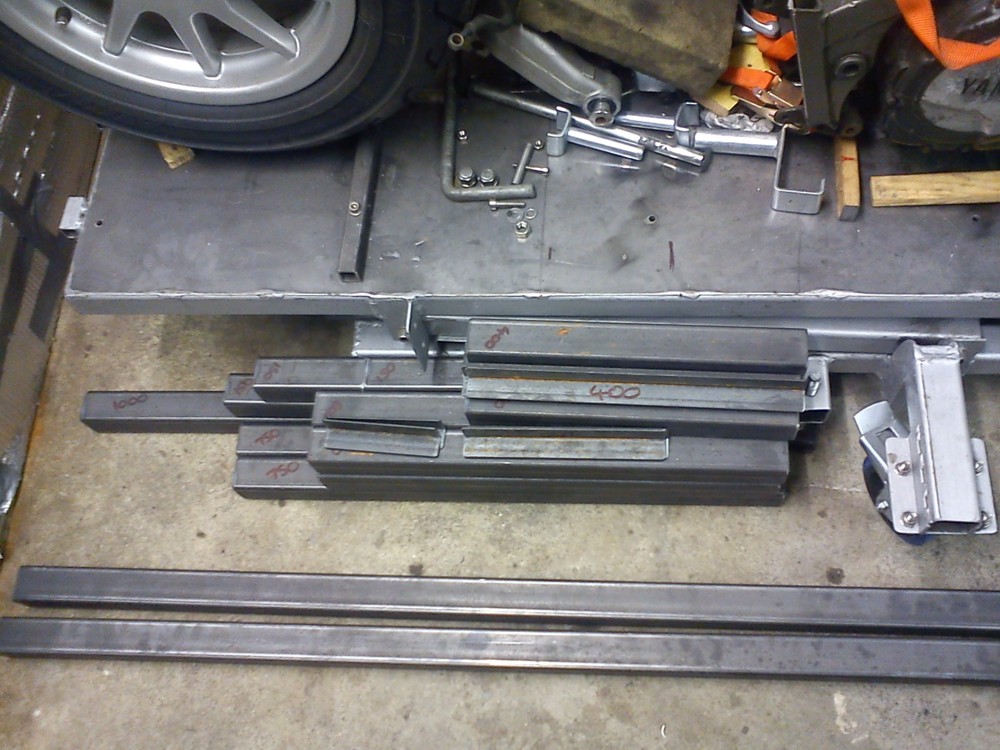

Ok so here's the story of my universal frame jig. It was designed from the outset to fit onto my bike table. A couple of reasons for this, firstly this would allow me to raise or lower the whole thing for ease of measuring and welding etc and secondly the table gives it more stability and rigidity, both of which are pretty essential in a frame jig.
Unlike most of the frame jig plans available on-line, mine is intended to be used for metrics and HDs alike. Therefore it had to be completely universal.....
I used 50mm x 50mm x 3mm steel box section as it fits onto the table, but if you are planning to copy it and use it free standing then use at least 50mm x 75mm for the main rails or they might bend under the weight - especially when you put the motor in

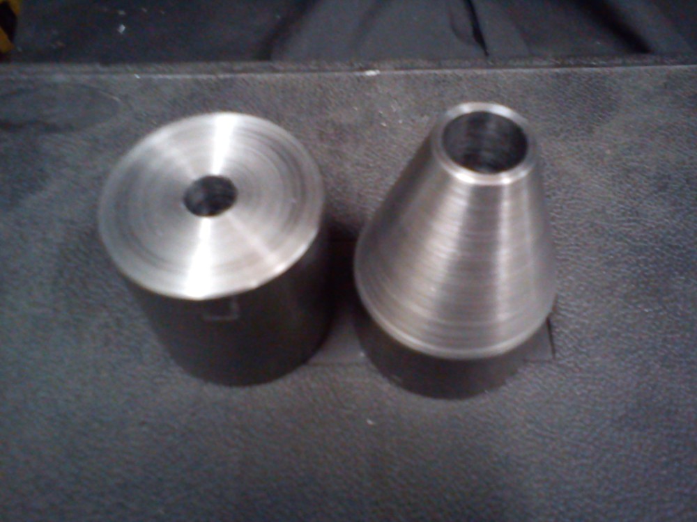

The location cones and neck pivot boss were machined from solid steel bar stock

To make the jig universal I designed a moving "saddle" which can take an original frame so I can measure up all the mounts to make up a motor mount jig.... This pic shows the basic jig layout before any welding...
