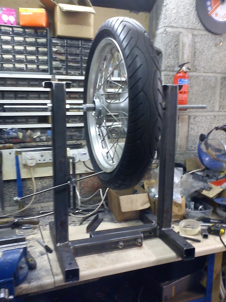

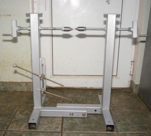

Just in case any of you haven't got a wheel truing jig yet and need one, here's one I made which takes rim sizes from super skinny 2.50x21 right up to 18 inches wide...

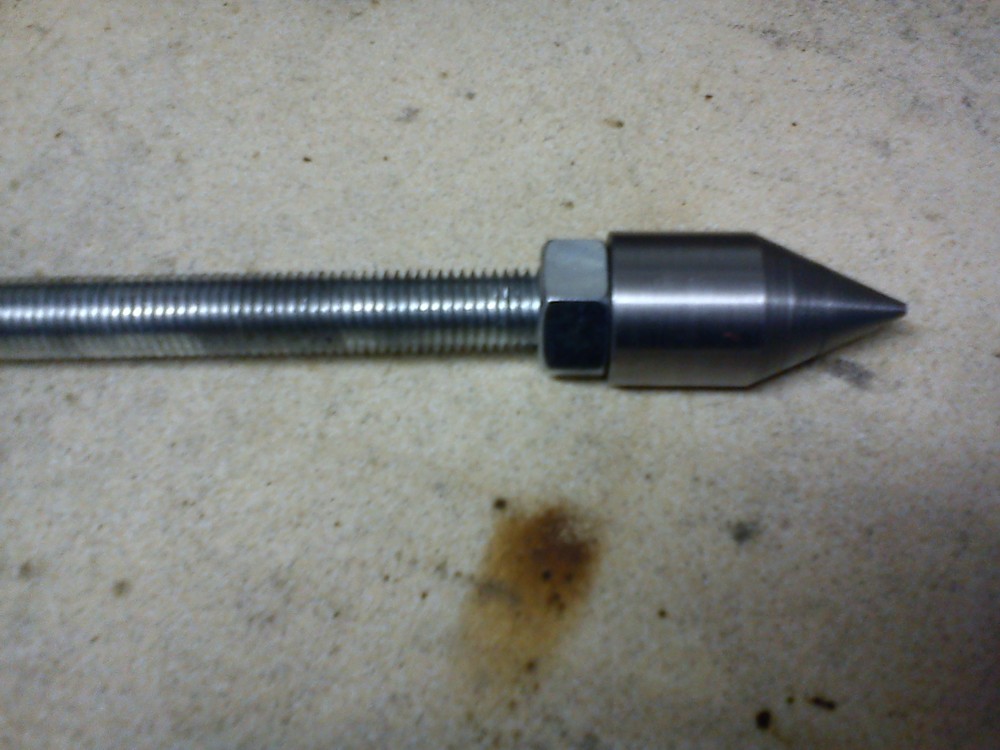

As you can see from the pics, it can take wheels with and without a spindle (axle bolt) and has dual run-out pointers.....I think I did some drawings of this :think: I'll post them if I can find them......

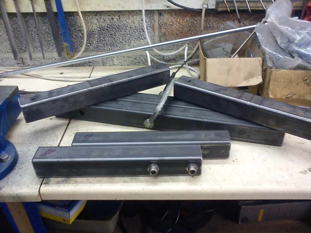

I got some leftovers from my Gotrikes bender and some 1' treadall scrounged off a constrution site...but I tend to over build anyway... ; )

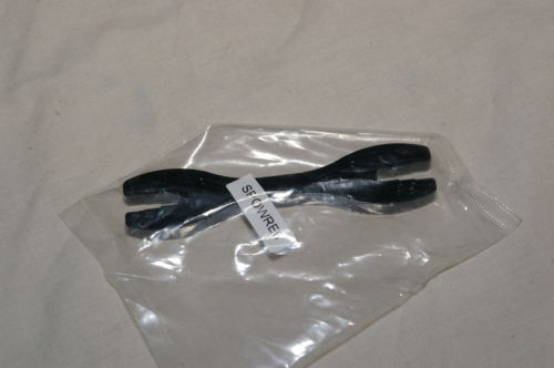

you will need one of these....
Spoke key.jpg (16.3 KiB) Viewed 28049 times
available from most good tool suppliers or evilbay.......
Re: Maz's Universal Wheel Truing Jig
i do have one of those actually never used it though
a guy who's never used a spoke and nipple key.....? :hand: don't believe it :snooty:
