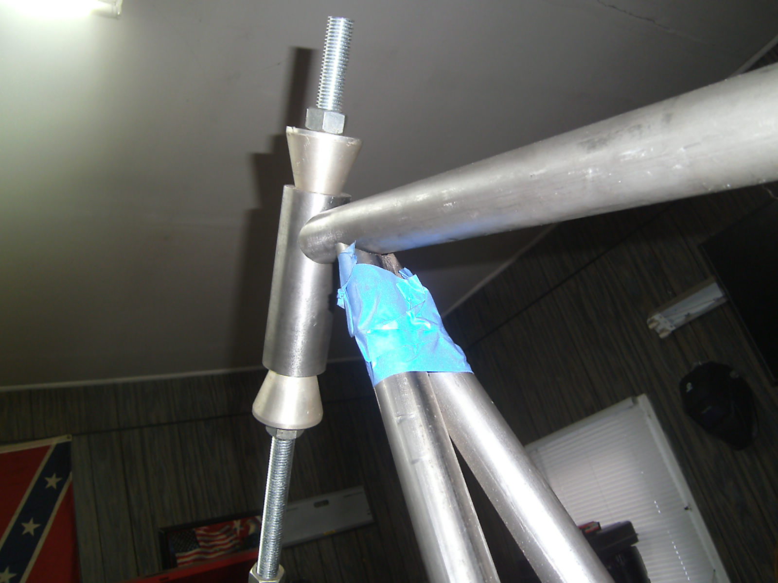

had a little time today bent up the lower rails to the backbone . im not going to bend the rails up to the rear till i get the notches finalized to the backbone so that will be a little while . i never made one that went to the backbone before 3 tubes coming together at one spot with all the angles. got the motor mounts set to the seat post now i got to get the height set and the top wishbone tubes cut to length and sliced for the axl plates.

you know your having fun when you keep takin 1/16 at a time to get everything all even from side to side i love that notcher

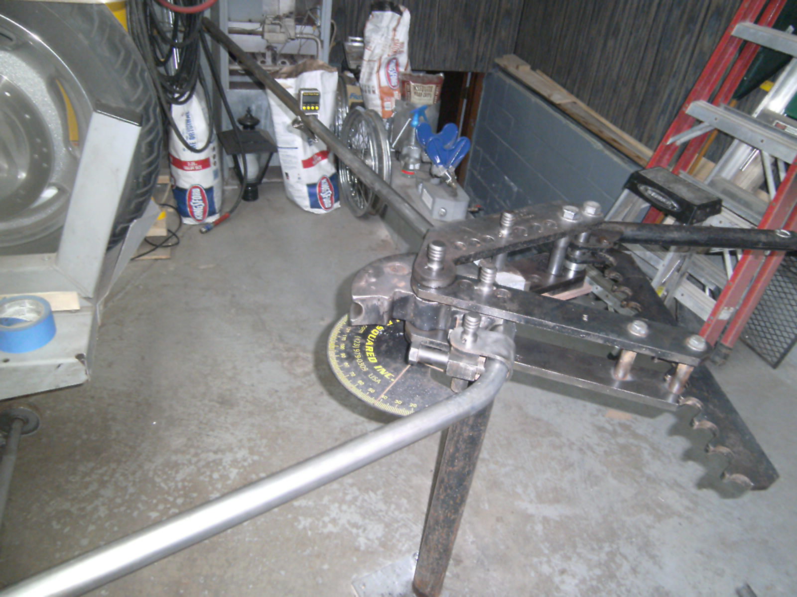

made three stupid mistakes today apparently i dont learn . first 2 i screwed the rotation on the final bend then on the replacement i put the bend on the wrong side of the line so now the 25 degree angle is to short to hit the axl in the right spot . :angry-banghead: :angry-cussingblack: :angry-cussingblack: :angry-cussingblack: i know i could cut and put a spacer and fix the rotation but i want it done right ........it looks like ill be taking a break for a little bit i gotta get up some funding for the new tube the holiday kind of killed me a little but i aint giving up
Re: new project
that rotation on the final bend has been the demise of many a piece of tubing! i have no doubt whatsoever that you'll nail it, though. just sucks you have to take a pause.
Re: new project
ya sucks but learned the hard way what i was doing wrong and ill keep the pieces and make something else out of them

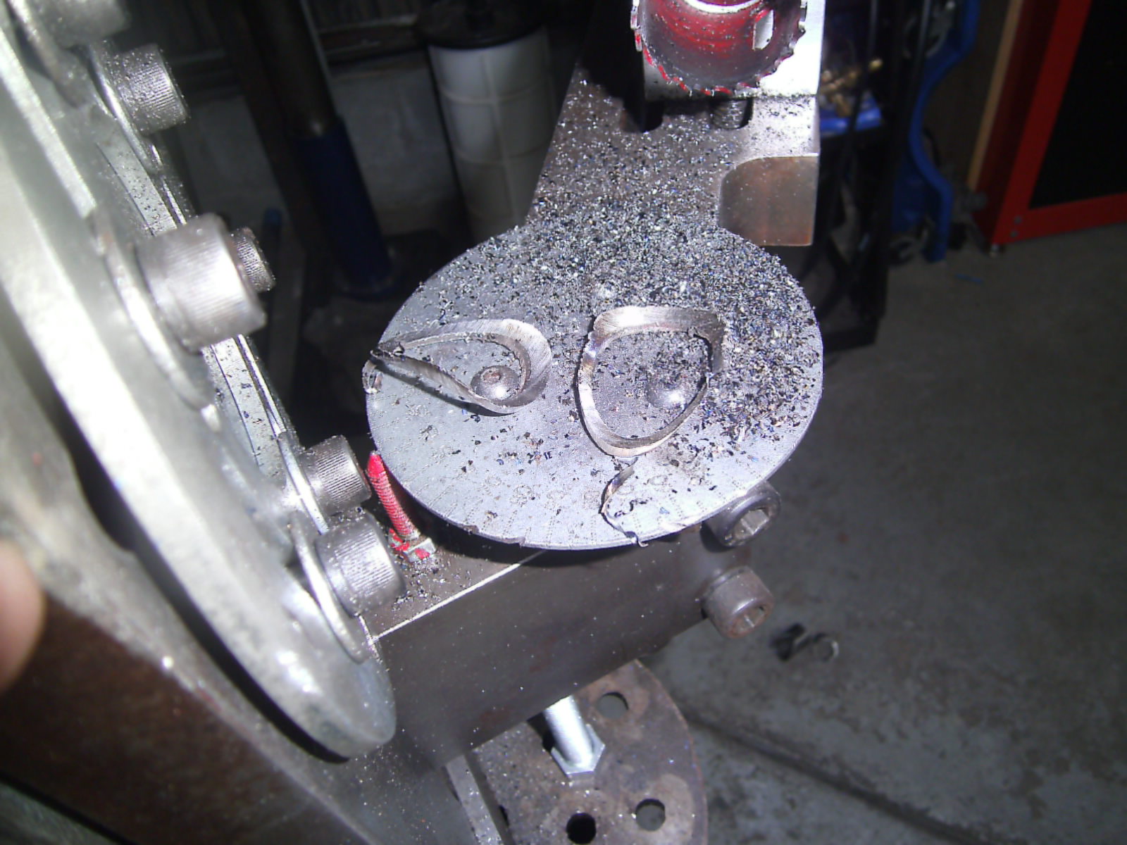

That is one hella beefy duty notcher ya got there Curt. I like
Re: new project
drivermark wrote: Fri Dec 30, 2022 3:11 pm That is one hella beefy duty notcher ya got there Curt. I like Baliegh tn250 super ridgid can cut offset and on a bend and over 180 degrees great for roll cages stupid nice for most all bike stuff but a pain to get setup going back to an even cut from an offset . i added a bolt to help and it would be nice if there were some common stops for like 90 , 45 and such

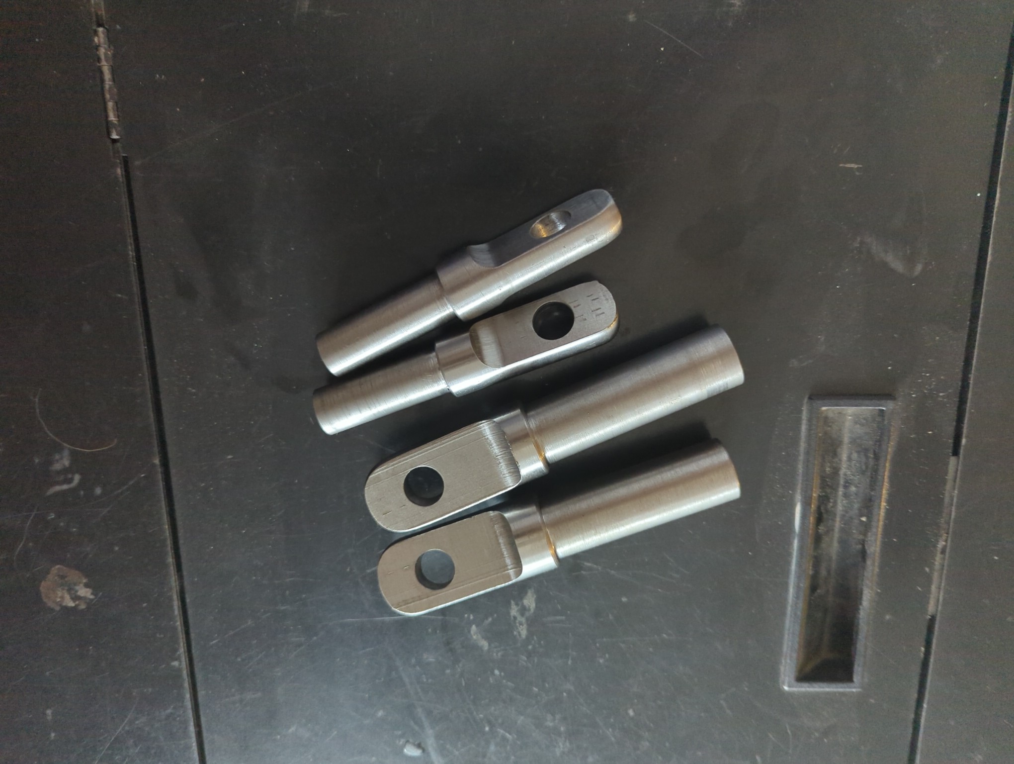

id like to thank drivermark for making these for me stand up guy who went above and beyond for me and i really appreciate it
Re: new project
Definitely some nice looking parts he made
