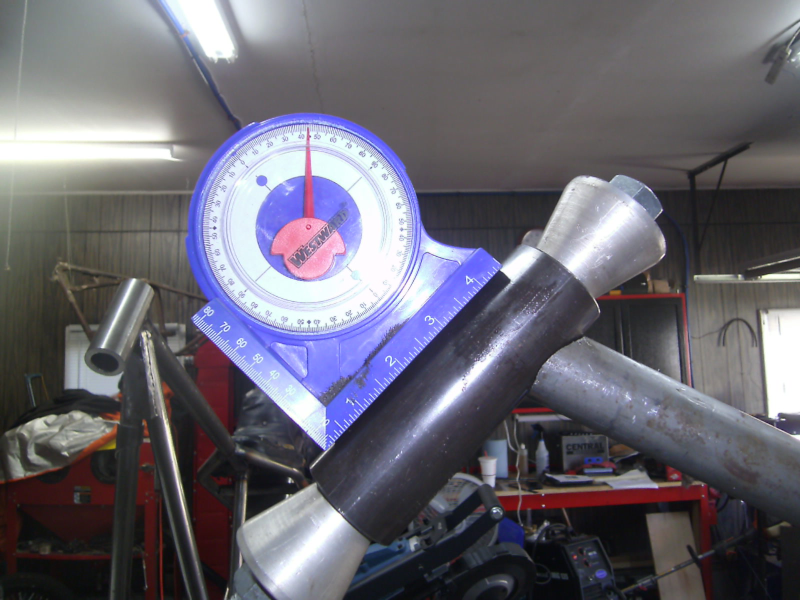

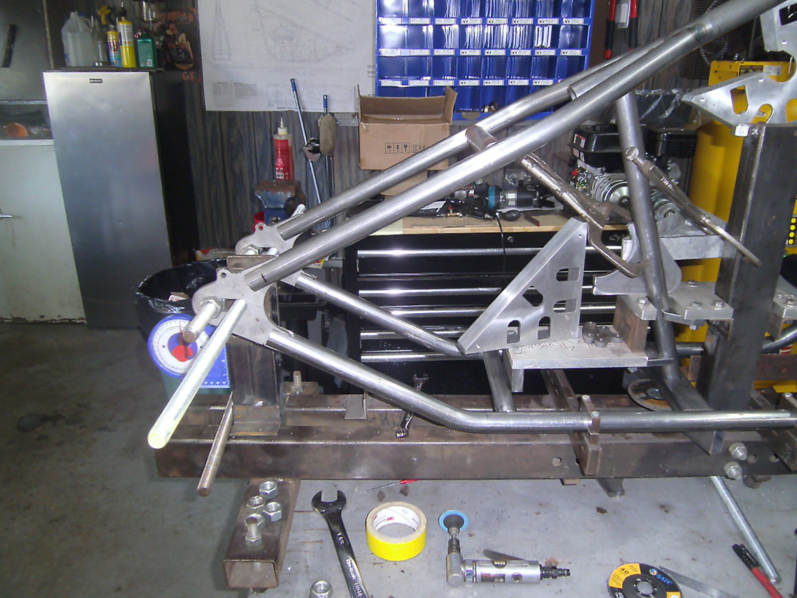

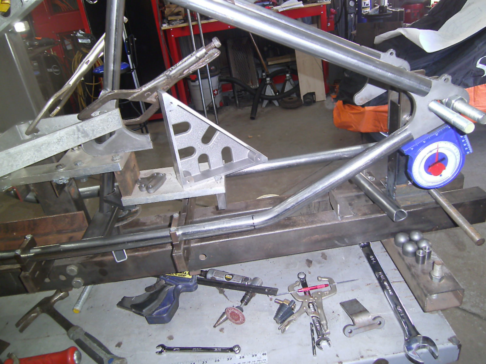

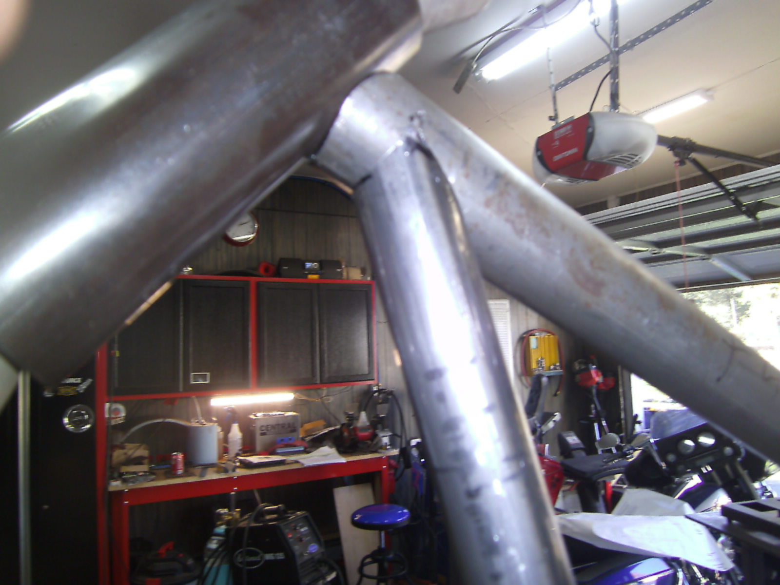

not a lot today took too long to get the fishmouths right on the seat post and neck and keep everything square and level but it ended up 45 degrees rake and 4inch stretch in the backbone . decided not to bend the seat post i did 2 and didnt quite like the look maybe the next one . gotta pick up some wire wheels so i can start welding or at least tacking

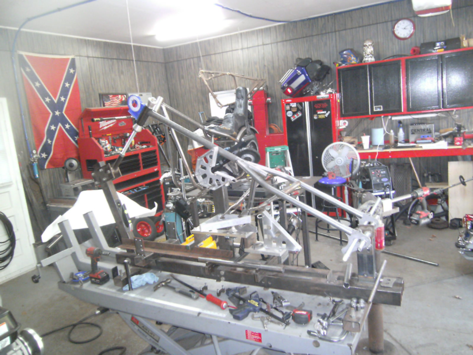

started the bottom rails today still need to work on where they come together then i can bend up the rear
Re: new project
really starting to look like something . gotta start the cleaning and welding . waiting for steel for the rear trans and front motor mount should be here this week . i have put the fender in and the king queen seat looks way better than the first one unfortunately i didnt get pics but it wont be long and ill be back to where i was before

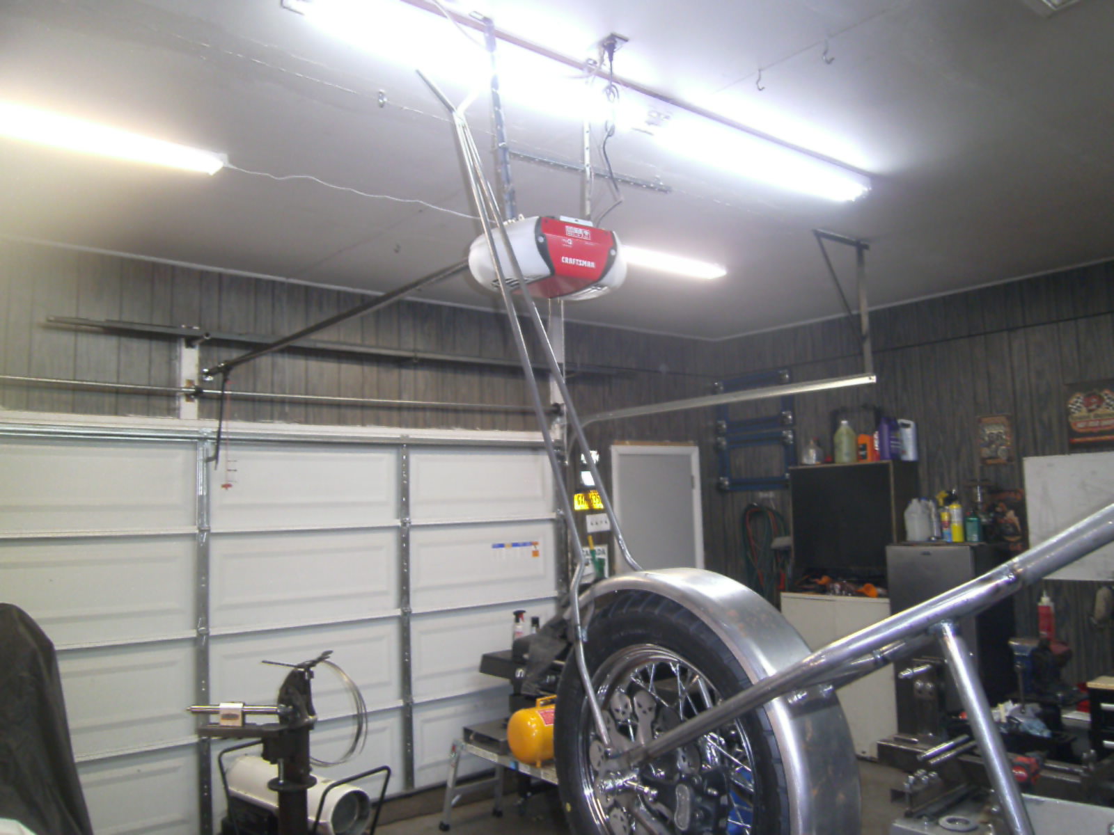

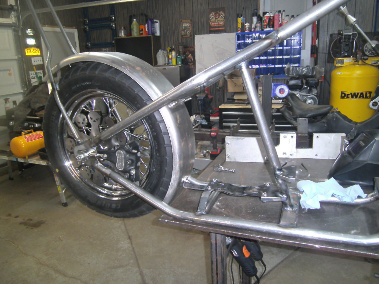

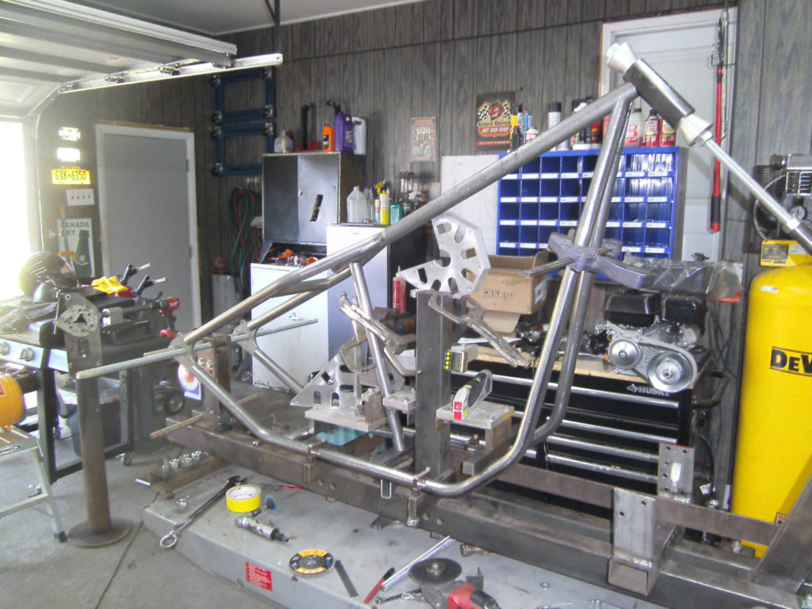

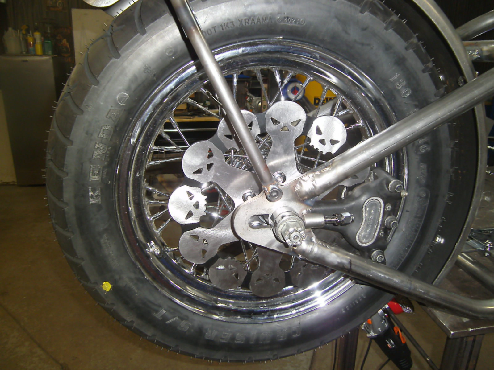

been making small progress got the welding mostly done got fender mounted the rear wheel is on but the spacing is off needs to be adjusted so i can make a brake mount made a 6 foot tall sissy bar its only 4 inches from ceiling on the bench it needs something like an insert or topper or both i dont know
Re: new project

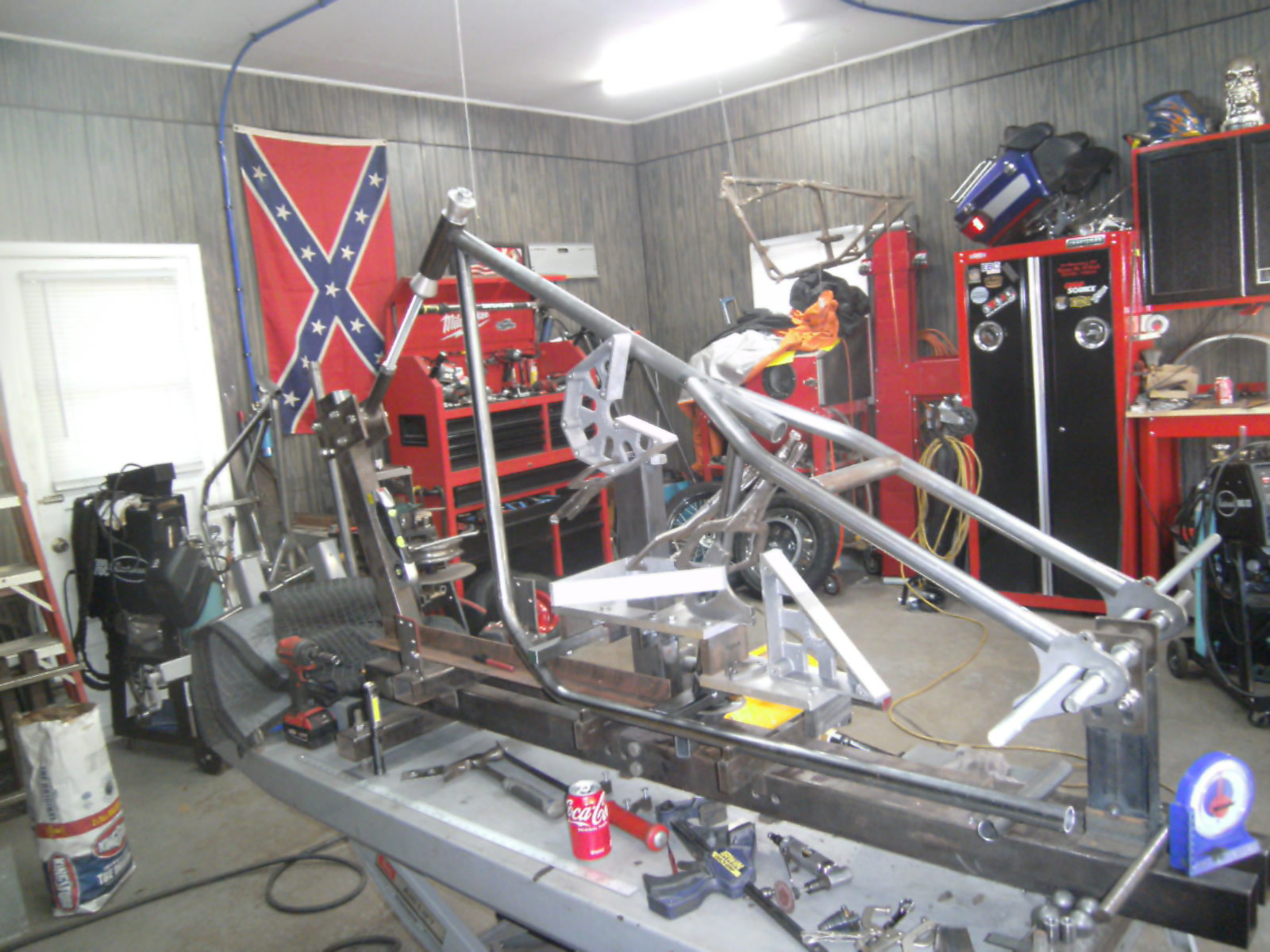

got most of the welding done springer soon
gettin there.jpg (260.73 KiB) Viewed 8278 times

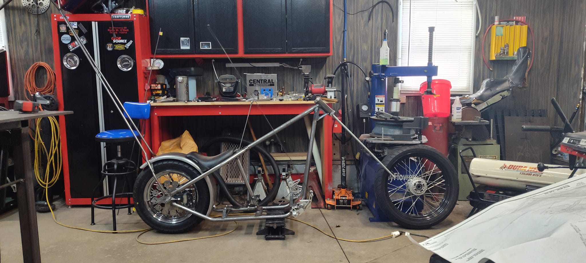

Re: new project
Got a nice stance to it. Got a tank in mind yet?
Re: new project
im thinking coffin tank

Looking good Curt. Where did you pick up that brake disc? That's somethin' a little different.
Re: new project
i found them on evilbay i got one for the front too . i figured because it has to be seen it atleast can look different

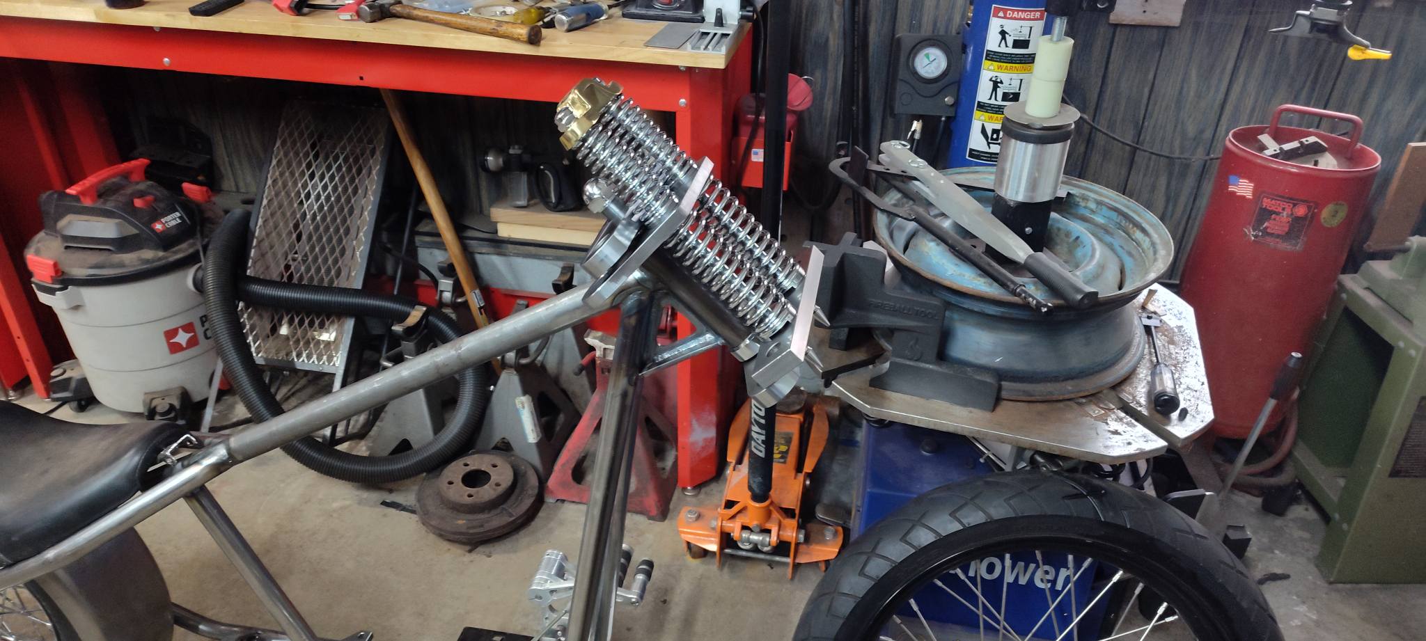

startin the springer need more tube ordering monday
