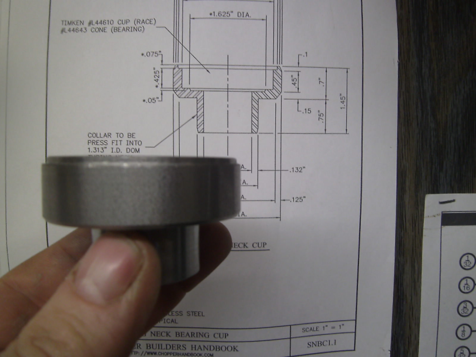

neck stems , axl , spacers , bungs ,,,,,,

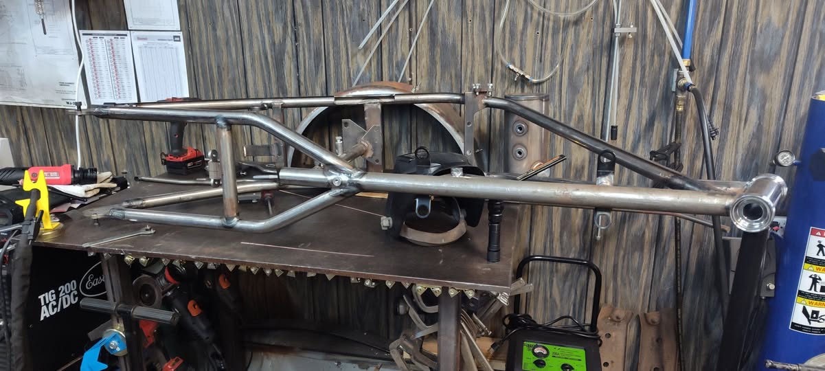

final weld.jpg (109.75 KiB) Viewed 937 times
playing on the new toy made a neck cup and some progress on the frame all the welding is done now just smoothing the welds out . didnt get pics will tomorrow but also took the springer apart and put in some lathe time squaring the legs up and making sure theyre exactly the same height plus sanding the tubes is way faster in the lathe

What material did you use for the neck cup?
I've wanted to make some nice shiny ones out of stainless but I get sticker shock every time I look at the price of that stuff.
Re: new project
just 1018 ya stainless is too crazy for me
