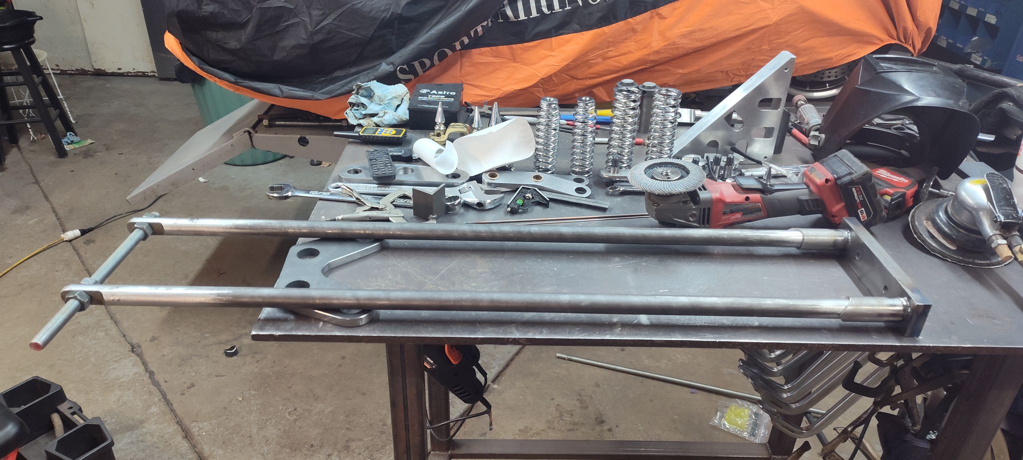

got some time welding on the front legs today didnt get pics but more to go tomorrow ill try to get pics . got the bottoms of the tube ground to 45s and drilled the rosette holes . welded the lower lugs in and ground and sanded came out nice couple small spots where i undercut a little but ill fill them in and regrind and sand till its perfect . it was a lot of heat today i dont want to warp anything so slow it is

a little more sanding and the front legs will be ready for primer . thanks again mark for making the lugs for me

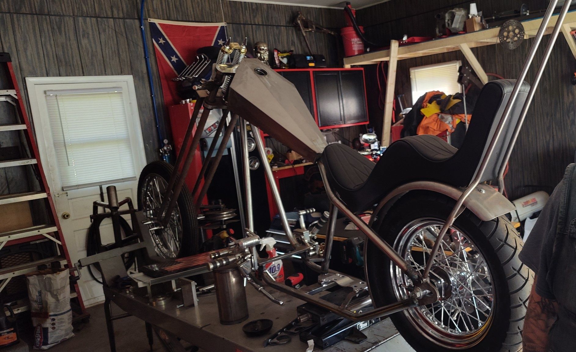

gettin there had to have the stem turned down was way too long . think i might have a deal on a complete evo softail drivetrain i gotta go look next week

Re: new project
been a little got the stem machined and up on the lift . got the tank need to mount it and put the sight tube setup in .i really need to find some time to figure out bars
