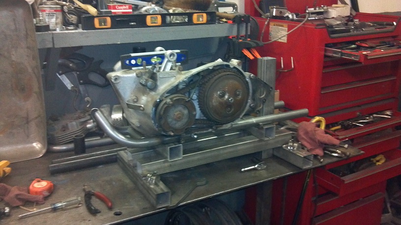

because of the 1-1/4 tube i had to dimple the tube to be able to get the motor to sit level front to back .heated it up and used a balpeen hammer to dimple it i dont like the way it looks so when i get it welded together in the real jig i will cut it out and weld in some plate to make it look better. the pic with the level is before it was finished i had to dimple both tubes i could have re bent the tubes and welded the mounts on top of the tube but i want everything to be similar to the old frames as i can and i like the tight clearances i hate haveing all that space between things makes it look like something is missing the tubes in the background are the backbone and downtube im thinking by the time i can get the jig back on the lift i will have all the tube cut shaped and real close so it should go together real fast

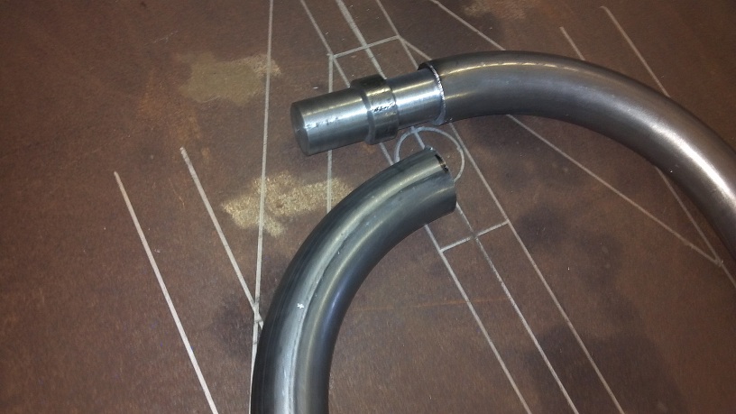

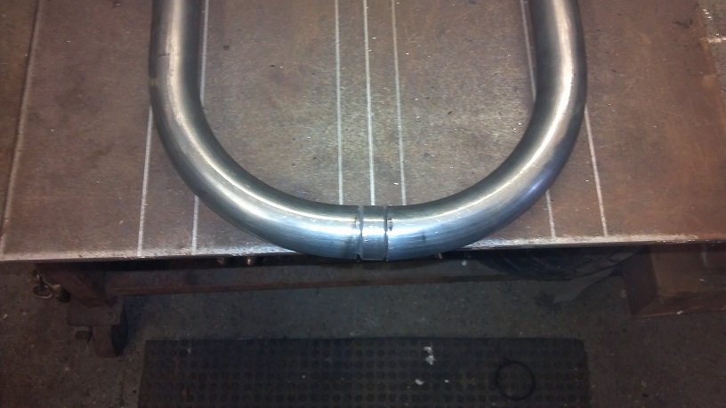

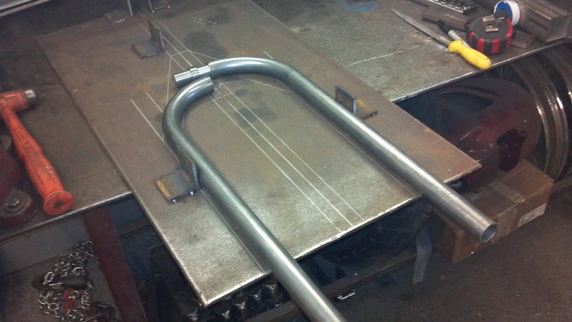

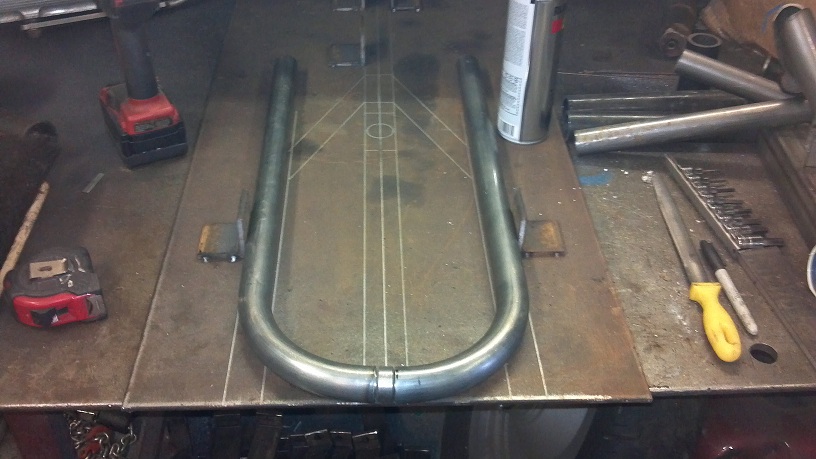

lil more progress today i tryed bending it in one piece but the first bend hit the die where it holds the tube when i tryed to line up my second mark so i made 2 90 deg bends turned down a slug took forever to shape the slug to fit tight because its right on the bend both sidestomorrow ill try weld it together without warping it too much. im useing it for the bottom wishbone because the frame where the motormounts is 5.5 on center and the wishbone is 9.75 and i suck at math cant figure out the double bend like on the fat tire bikes. the top will be like a traditional frame upper

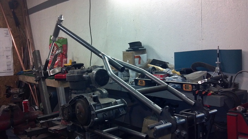

not lots of progress but i knew this one would be slower i dug out the real jig and started gettin things set in place i know i want a 45 deg rake and the back bone at 25 to match the axl plates so i cut the miter at the neck and tacked it set it in the jig i dont have the axl plates yet so i stuck a smaller tube in the back bone to help line it up for height i should be done with the plates this week so i can get the top half of the frame doneif i can get the weekend off id like to see how much i can get done well see
