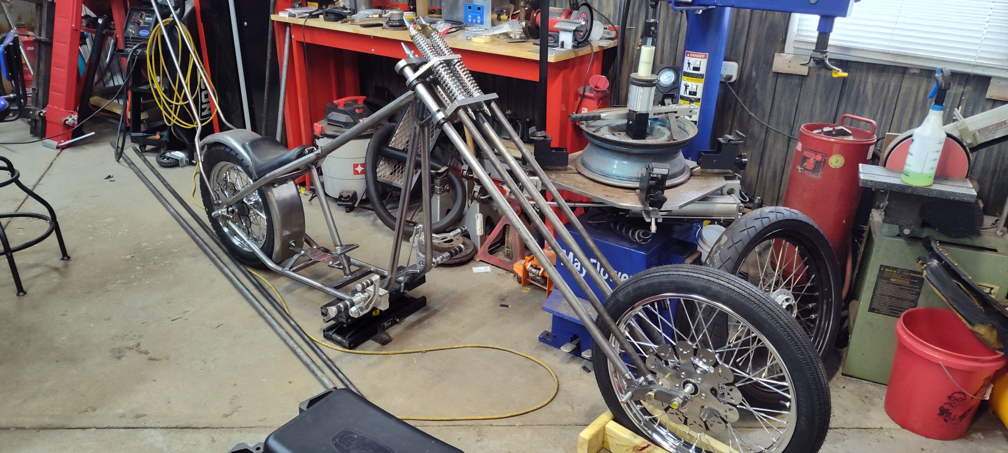

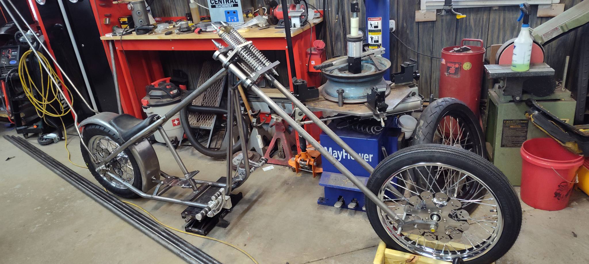

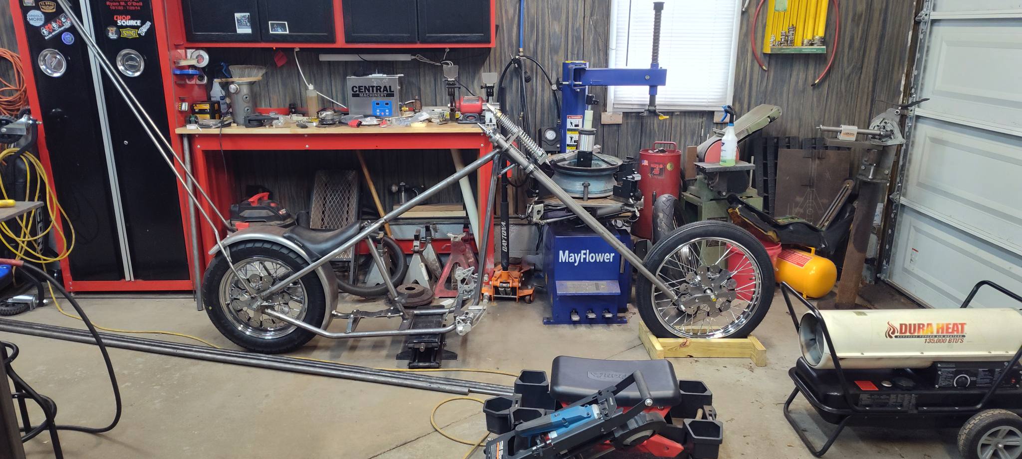

hoping to get to the front legs this weekend . found a tubeless front rim didnt even know you could get tubeless spoke rims way cool i hate tubes
Re: new project
a little time with the welder and it will be a roller
