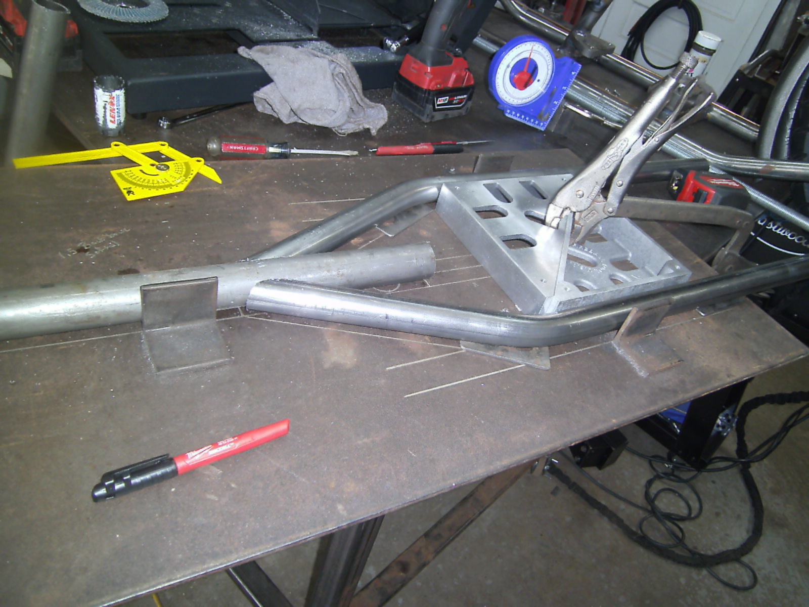

Modifications to the BC Sportster Frame drawing
[img
DSCN0097 by mark perkins, on Flickr][/img]
This is the jig I built, some chipboard axle plates for mock up and what I have done so far on the down tubes.
The lower rails are gonna be fun to figure out. I will be modifying the modified drawing again as I don't think I can come close to doing
those bends in the lower rail. I will have to adjust the angle and the position of the first bend to make it work.
(good thing my son is good at math because it's definitely not my strong suit)

DSCN0097 by mark perkins, on Flickr][/img]This is the jig I built, some chipboard axle plates for mock up and what I have done so far on the down tubes.
Re: First attempt at building/customizing a frame
the worst part is bending and fitting one side then having to mirror the other side but after you have done one everyone after that gets easier
