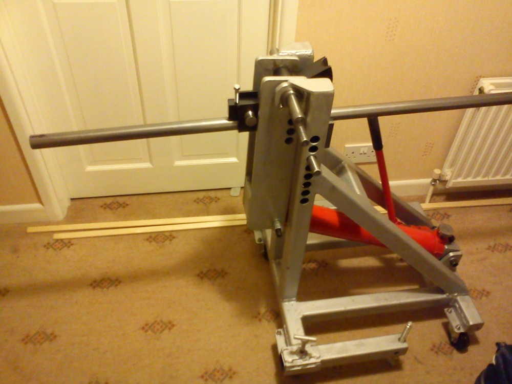

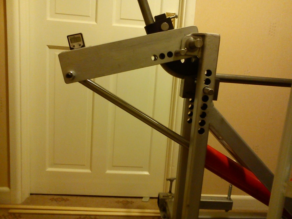

or build yourself one of these
GS550 Bobber 040.jpg (126.46 KiB) Viewed 25795 times
GS550 Bobber 043.jpg (122.26 KiB) Viewed 25795 times
I used this monster bender to make all the frame parts (and handlebars) for my GS550 and also the diamond section frame....and some handlebars for a good friend's Buell chop..... :banana-dance:
I've replaced the manual ram with an air/hydraulic since I took those pics...... very easy to use and doesn't need fixing down....... :snooty:

Maz wrote:or build yourself one of these
Maz ....when are you going to mod that die for the D-ring and tube clamp....???? ......Then you can do up to 270 degree bends ....!

I suppose I should be honoured to be thought of as a redneck....but I'm just an English Witch really guys...... :snooty: and the nearest I get is probably "go on, you know you want to...."
As for the bender, yes I am looking at making a ring clamp for it, I've just converted it to an air/hydraulic ram and I have several dies for it, some made by me (including my diamond die) and some bought from an importer...
I do have some die plans and as soon as I can retrieve them from my "dead" hard drive I will share them with any of you guys who want them....... :banana-dance: meantime if you are making a die and can't figure out the profile of the groove, some of mine are circular but with a small ridge around the middle which prevents the tube from deforming........ :think:
