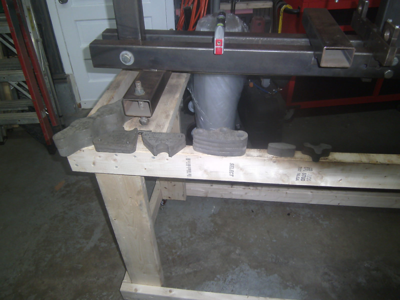

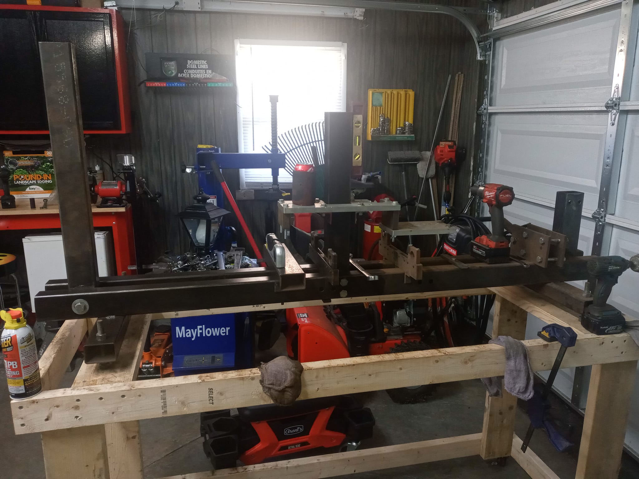

starting a long term project . this is going to be real slow . i have nothing here or even most of the tools as of yet but i am starting with disassembling and cleaning the jig been sitting in the corner for too long . built a little bench on wheels so i can move it around .

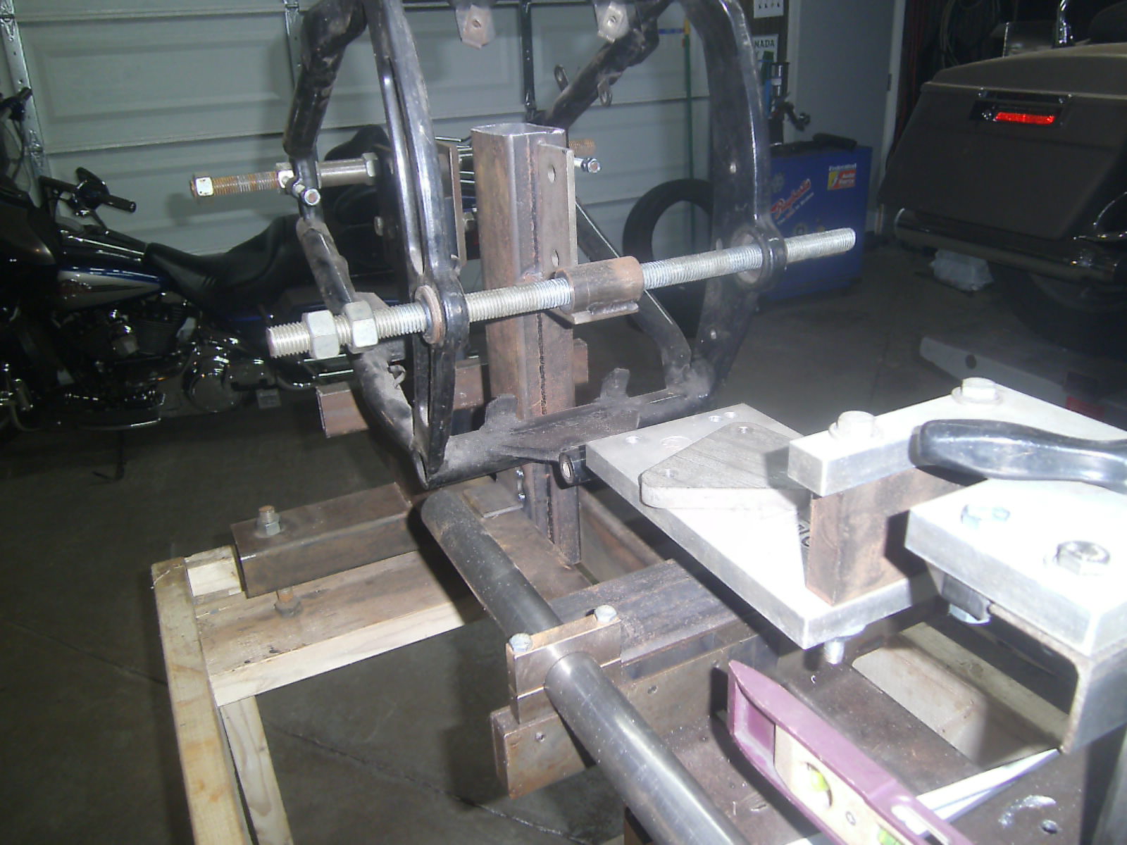

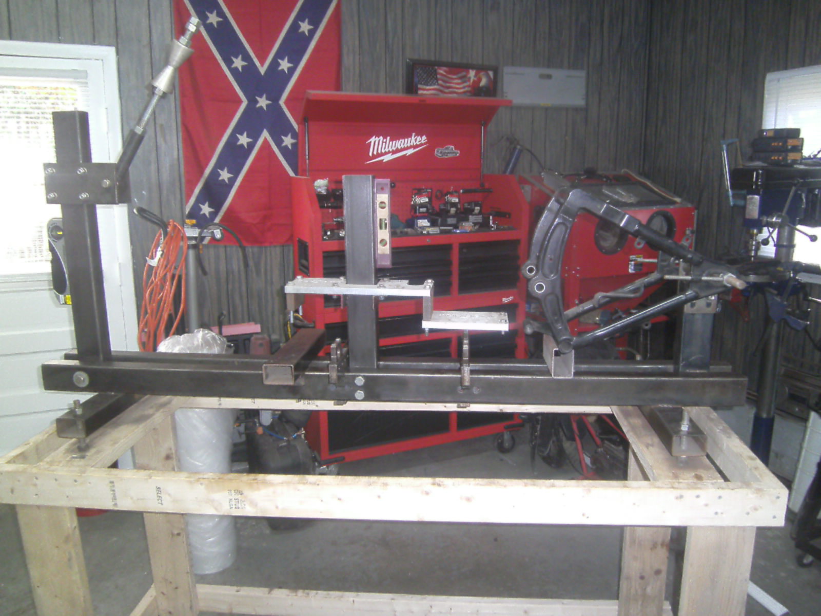

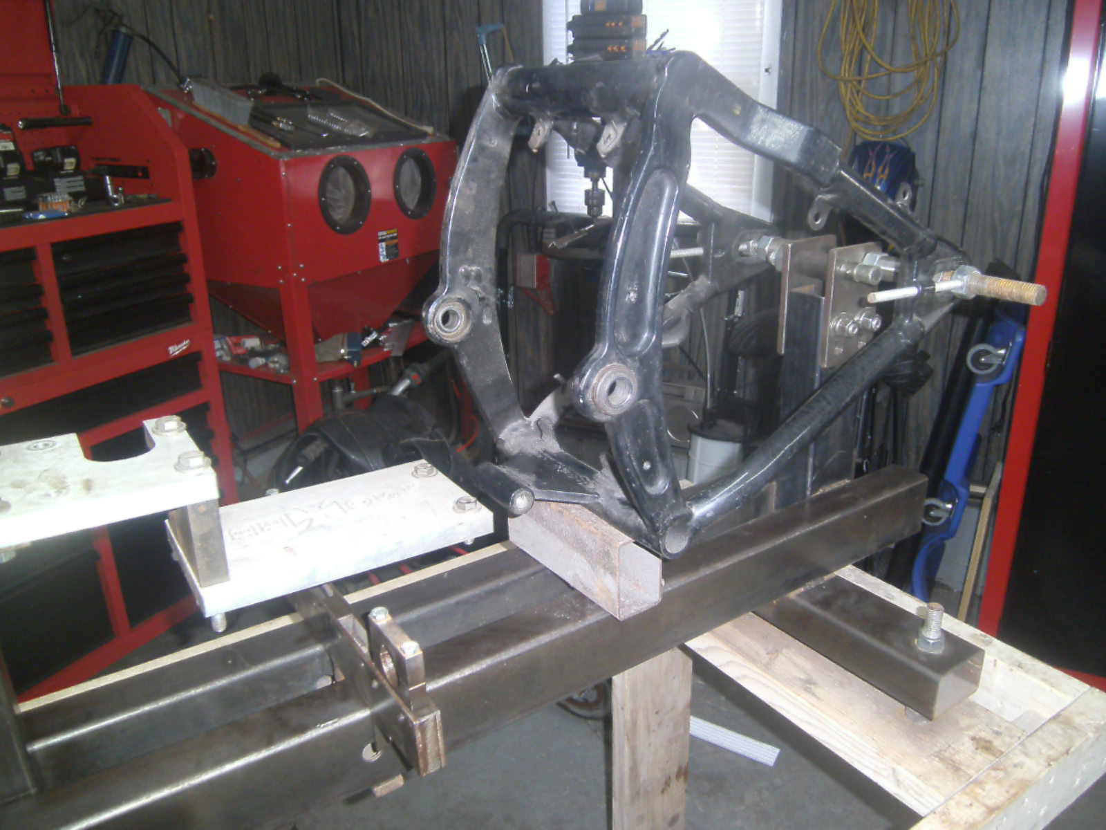

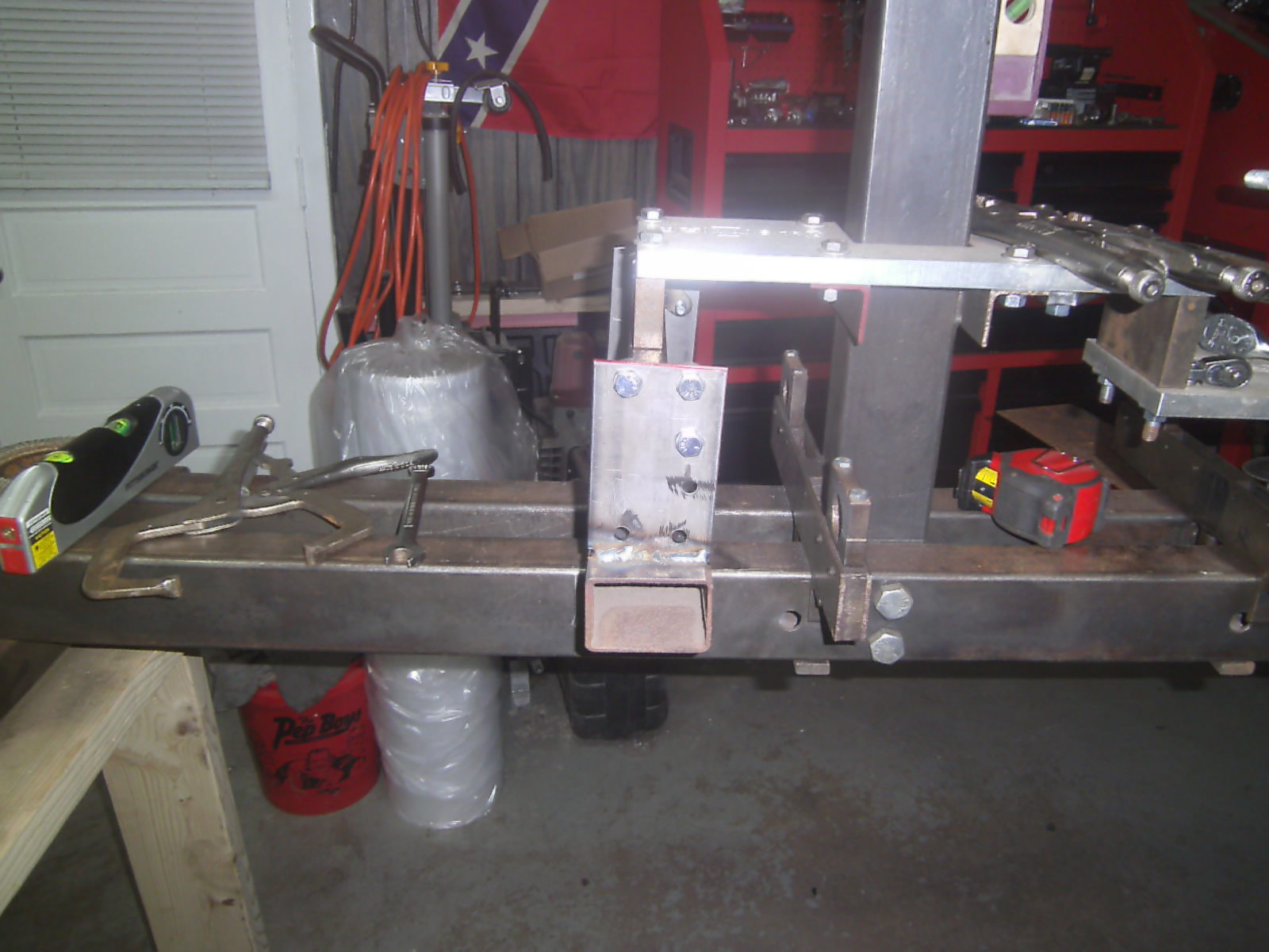

got it cleaned up seems im going to have to remake a few pieces the control mounts and softail swingarm mounts are missing i cant find them anywhere but i did find the swingarm so it should make it a little easier . wish i had a frame for the top motor mount but i guess i can get that later .

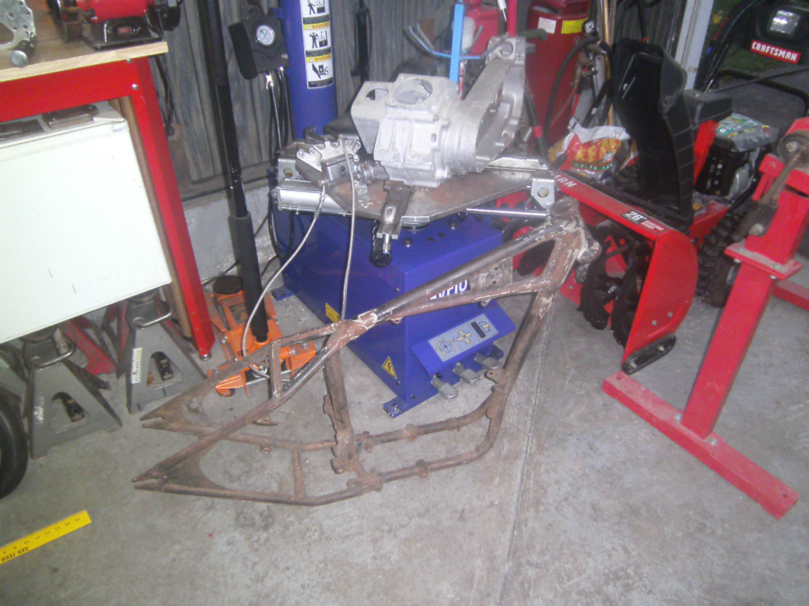

found enough motor , trans , control , and springer parts to do 2 bikes cant find front motor mount but if anything thats the easy one and 1 steering stem for the trees . all stainless going to be a bitch drilling those trees and spring perches but should polish up like chrome when done
also found the tube nocher a set of shovelhead cases with primary and a stock triumph frame with bolt on hardtail . everything been sitting so long its all in need of some serious cleaning .oh found a pm front brake setup and billit aluminum forward controls and a couple different kickstand setups also so it looks like i was pulling parts before and forgot what i had

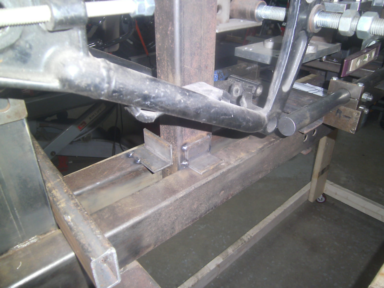

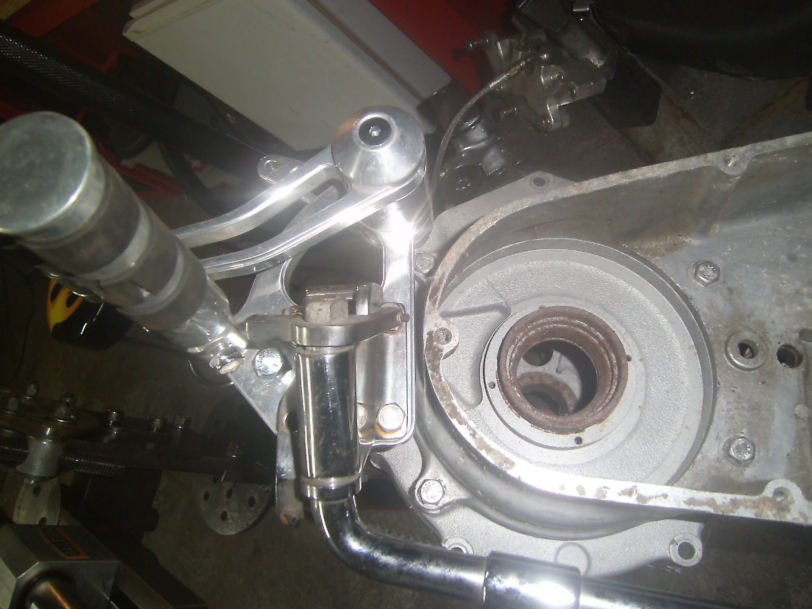

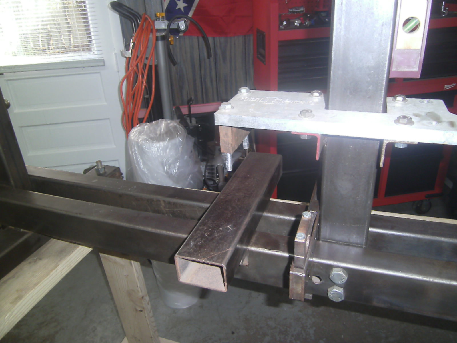

made a little progress today not all good but .... i got some metal for the neck had to get a new threaded rod the old one got bent in storage somehow need to cut the new one down . then i got a 1x1 square for the front motor mount see a problem with the left forward control some dumbass welded it on backwards . but at least i made the mistake of welding them both on the same height so i was able to just flip the whole mount . seems to fit the shovel motor and primary but tighter than id like . anybody know what the clearance on an evo is i dont have a frame or dummy to check against right now

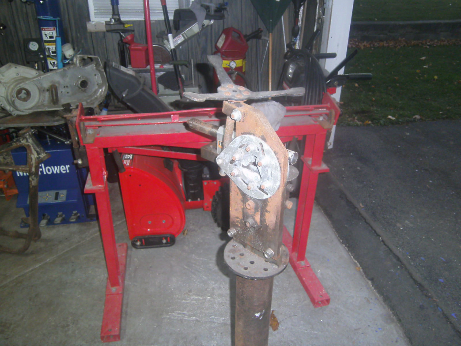

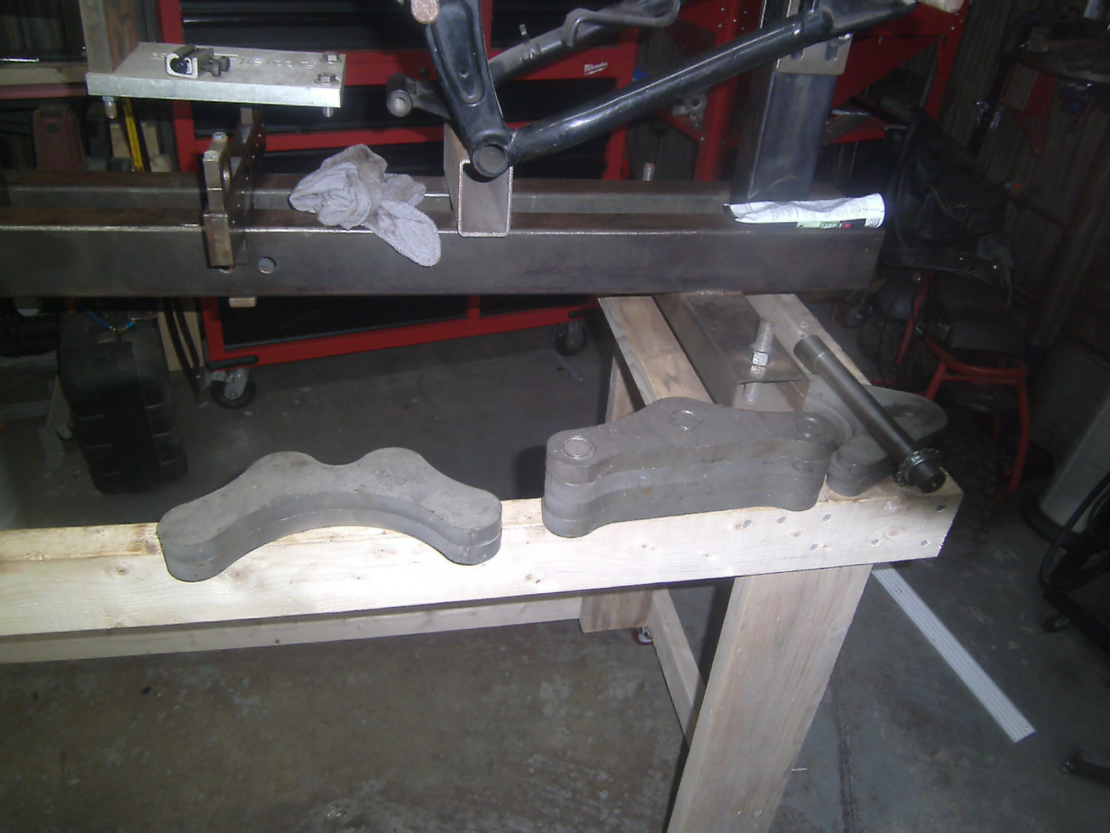

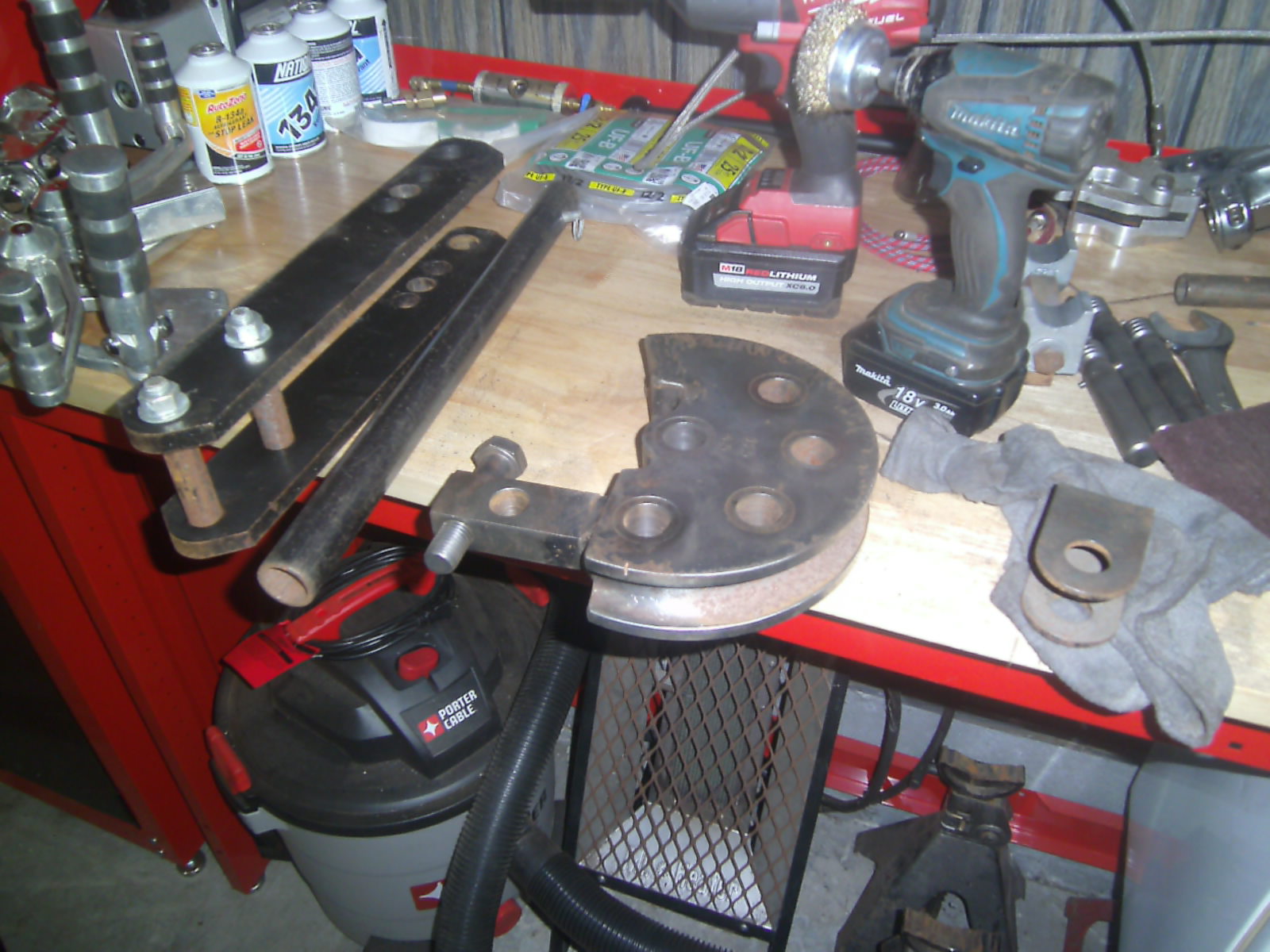

got the notcher cleaned up and the bender out of storage . although it dosent show well in the pic the die is very rusty so the whole bender needs a good cleaning and i fixed the position of the control mounts as far as height on the jig now i got to get them settled as far as front to back of the mount . herd from my steel supplier the snow storm in buffalo is going to delay my tubing delivery at least a week maybe more . i guess i got time to sort things out

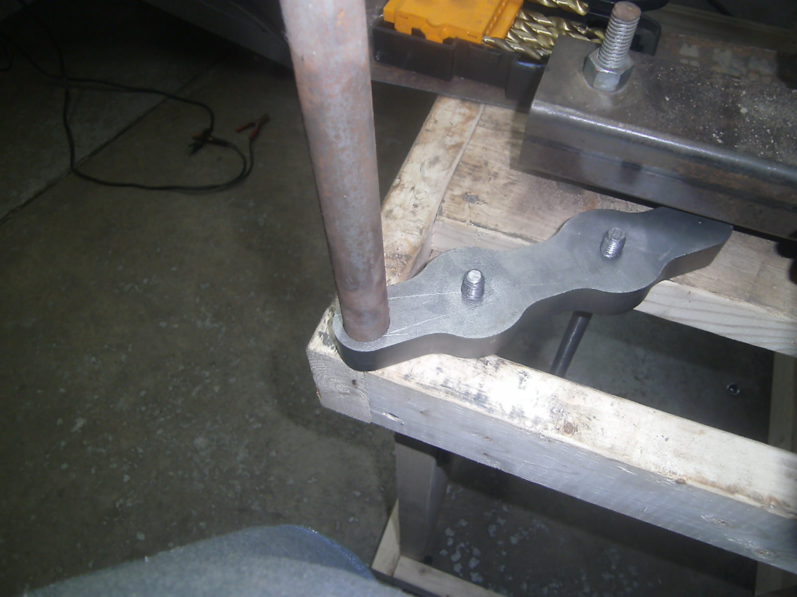

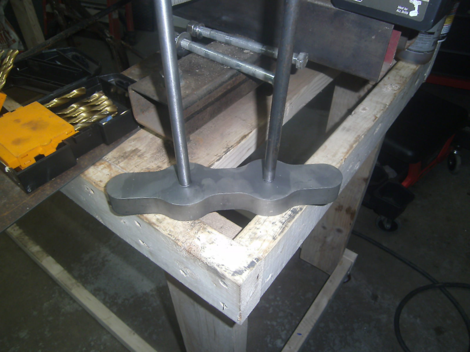

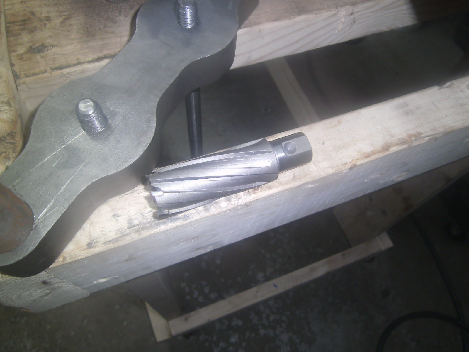

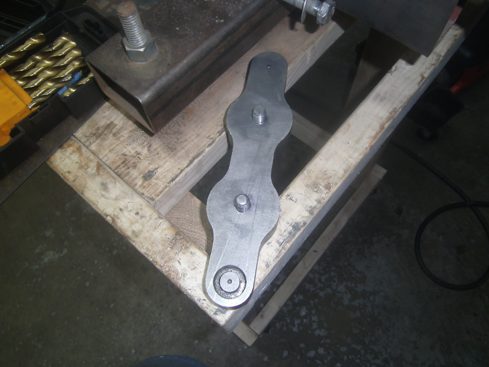

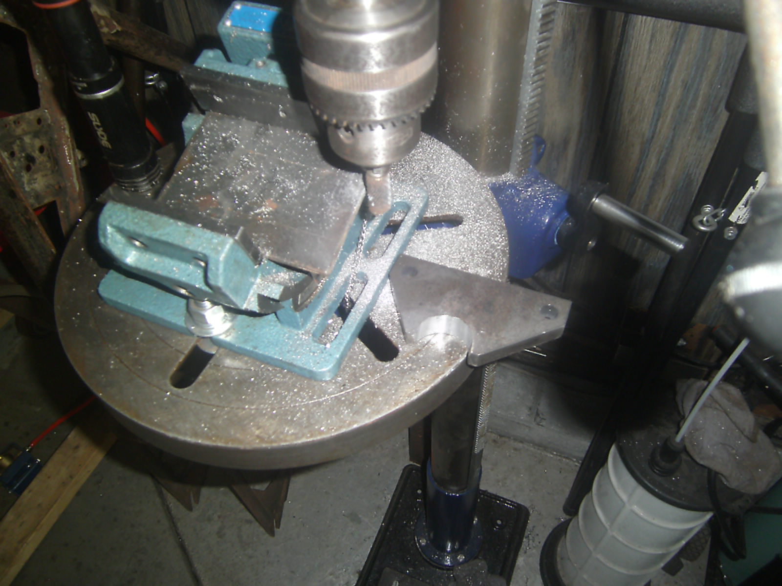

did a little drilling on 1 inch thick stainless steel slow is your friend . i find if you use an annular cutter bit with carbide teeth the hole is big enough to use 120 wall tube so you dont have to drill all the way through the plate . i think i can go 3/4 inch deep and drill the center hole and still slug the tube and bolt it in still like the plans . little longer bolt and a little deeper in the tube but the tube will still be locked in the plate

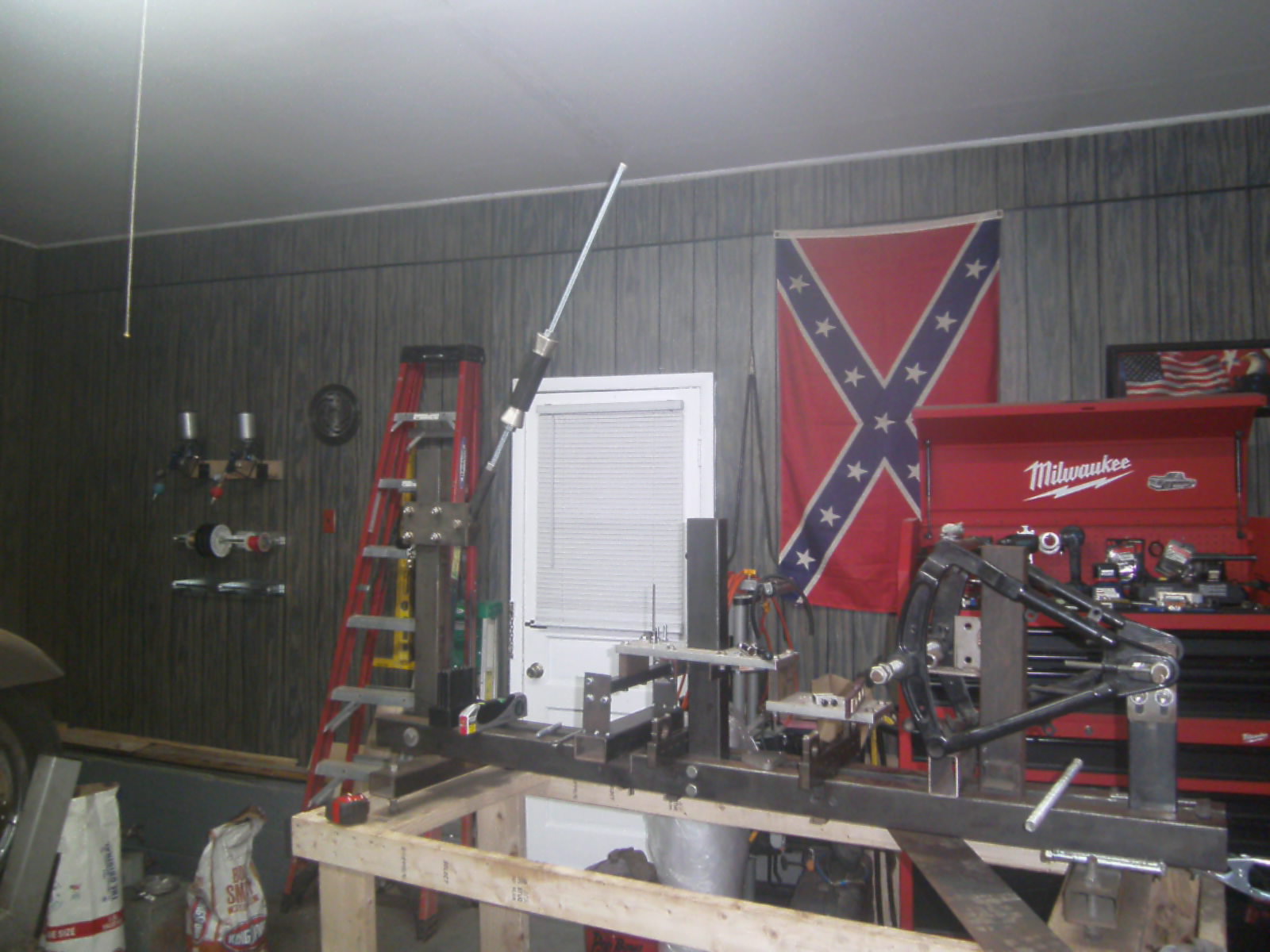

played around with the post for the softail swingarm today got it positioned where it needs to be . also measured out all the motor and trans positions made sure they were square and level and proper distances . not a lot to show but lots of time . from the rear axl to the front mount im getting less than a 16th variation from the plans hope i can keep it that good when the metal starts getting bent and welded . now if the metal would just show up . tomorrow see if i can get the main spring plate drilled maybe

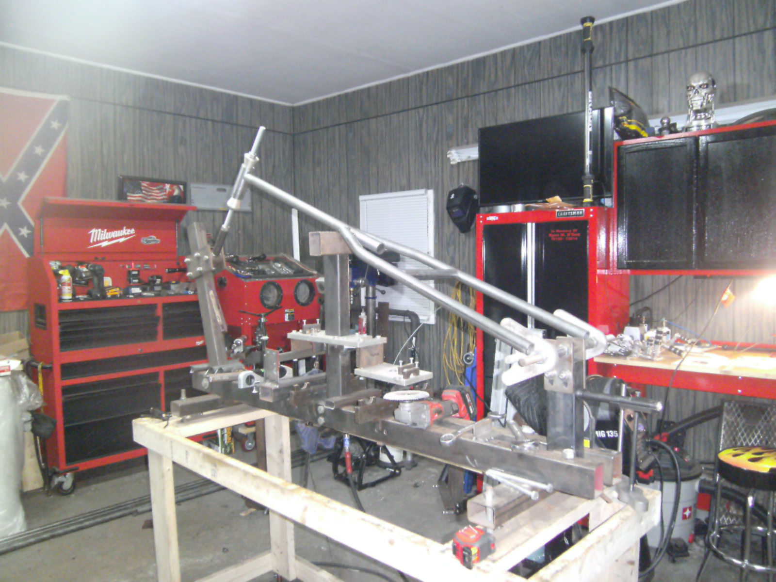

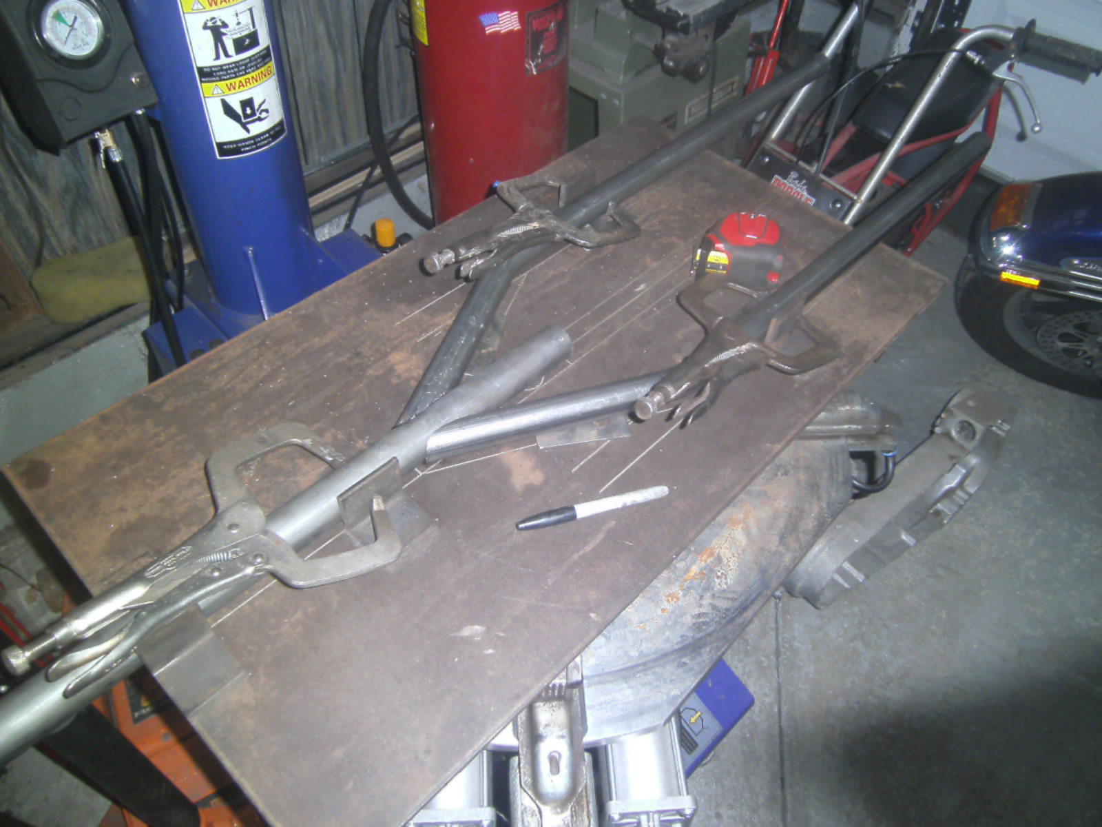

got the bender setup and bending today notched out the wishbones took about 6 tries and a used hole saw to get them perfect . tomorrow i plan to clean up the notches and tube to tack everything together

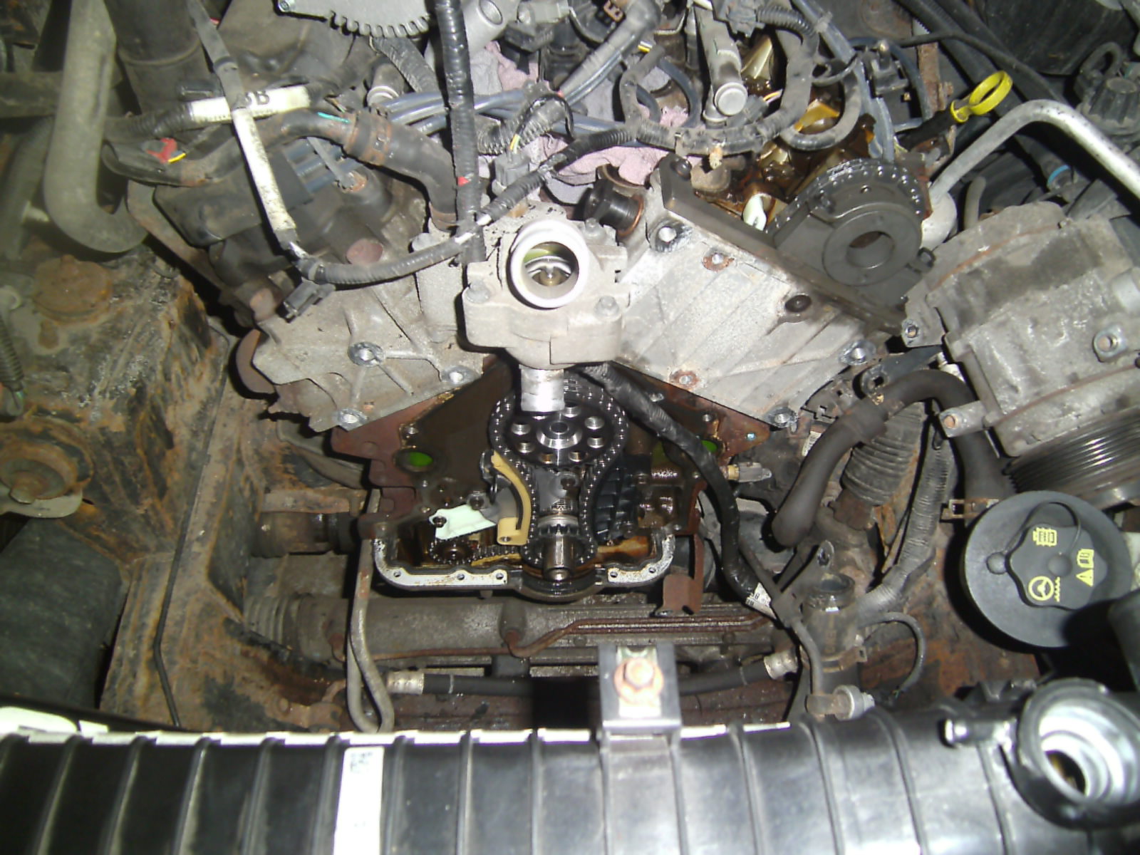

its good to be back at it but i been stuck working on the daily . took a week to get the timing chains and tensioners should have the torque to yield crank and jackshaft bolt tomorrow . what is it with having to wait for everything anymore and not just a day or so but a week or more

got my garage back had some time to clean the notches and a little tack welding . got to work on the seat post tube so i can lock it in and start the bottom tubes
