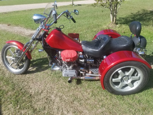

It went on its first test ride this evening.
Lots and lots of tuning yet to go.
But it is an arm stretcher already.
The drop pivot linked shocker front end seems to work.
Stable and controllable. Not twitchy at all with very low trail.
Less than an inch.

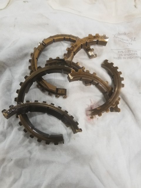

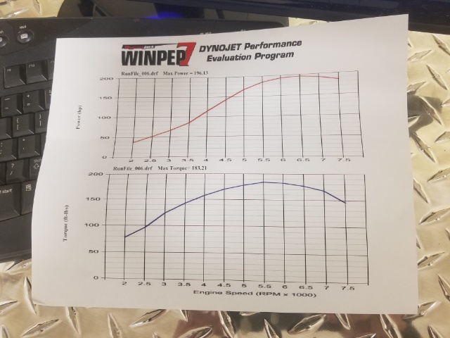

It made some hp.
And broke the trans in third gear.
The trans is built....should hold 200hp....but I did around 225 at the crank. Something is going on with 3-4 hub. Gears are still there. But not shifting right and syncros dont work. No gear whine but all loose and clunky like backlash. Just checked the shaft end but and is tight and shaft not moving in- out. So I am guessing a thrust bearing inside.

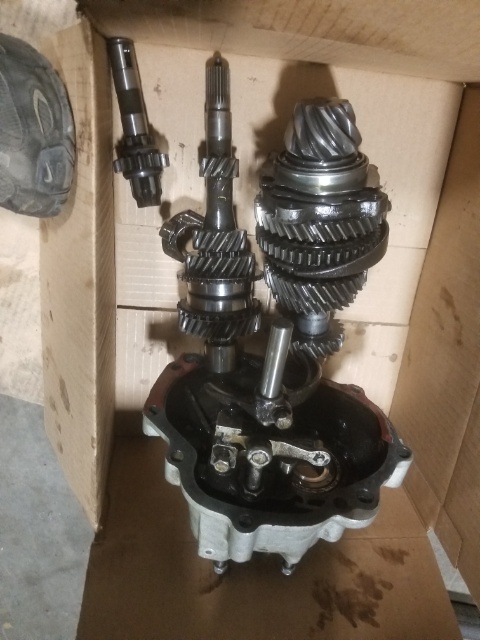

Will be pulling trans back down soon.

So what it was.....
The aftermarket hub and slider on 3-4 deformed a bit. With the hub out of round the slider did not line up with the synchro. I broke the brass sychro rings continuing to drive it.
Now I am told that an original German hub is better and use the aftermarket slider.
So it all went back together with used parts.
And I am back in the wind.
No more full throttle dyno pulls for me. It is easier to accelerate the bike than the dyno.

You can reverse the trans output by "flipping the diff".
Which is removing the differential and ring gear from the case and then installing it from the other side.
You need all the appropriate gaskets and then re-shim the ring and pinion gear mesh and backlash. Fairly simple to do.
Mine is not done this way.
I flipped the entire trans, not just the gear.
The trans has to be fully disassembled and internal machine work done to the oil passages.
A bit extreme.....but.....it makes the drive line about 6 inches lower than it would be in the original car.

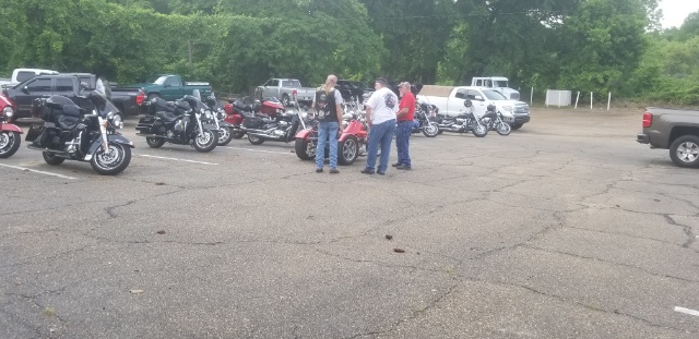

I went to a bike rally and it was popular to look at....but overall they did not have a clue what all went into it.
I have been to a couple hot rod car rally's and them guys understand what all it is.
