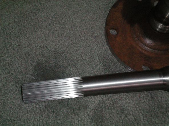

- 16 resplined axles.jpg (99.73 KiB) Viewed 18555 times
- 17 resplined axle end.jpg (99.87 KiB) Viewed 18555 times

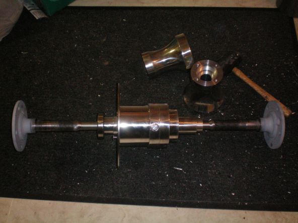

- 18 diff bolted together.jpg (90.59 KiB) Viewed 18555 times

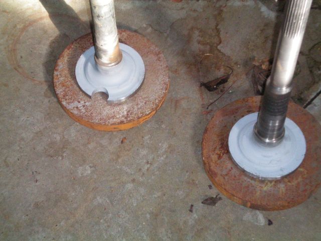

- 24 old flange turned down.jpg (103.92 KiB) Viewed 18555 times
- Dana 30 modified differential.jpg (98.24 KiB) Viewed 18555 times

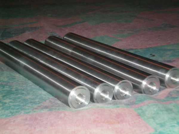

here are the spacer rods done.
12 inches between shoulders, 1.250 aluminum.
overall length of 12.230
drilled and tapped an inch deep on each end with 1/2" 13tpi
