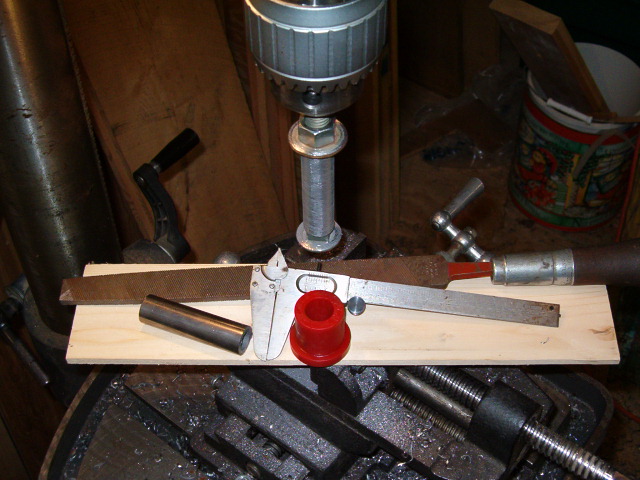

using drill and flat file to turn down inner sleeves for motor mounts
old fashined lathing.JPG (115.36 KiB) Viewed 22661 times
