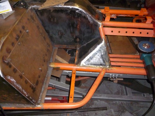

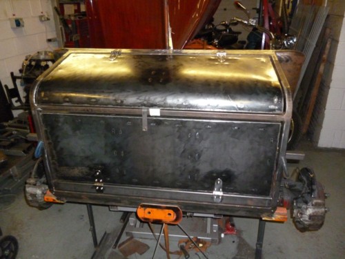

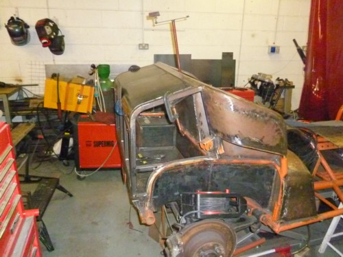

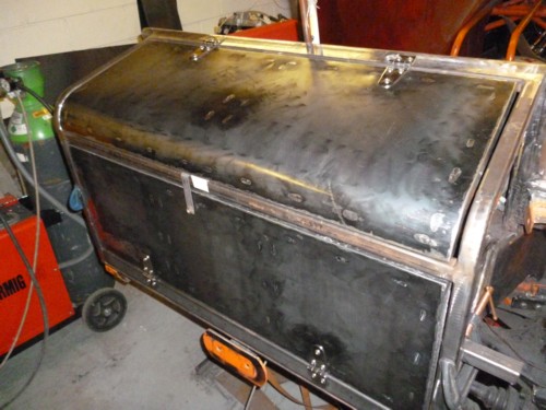

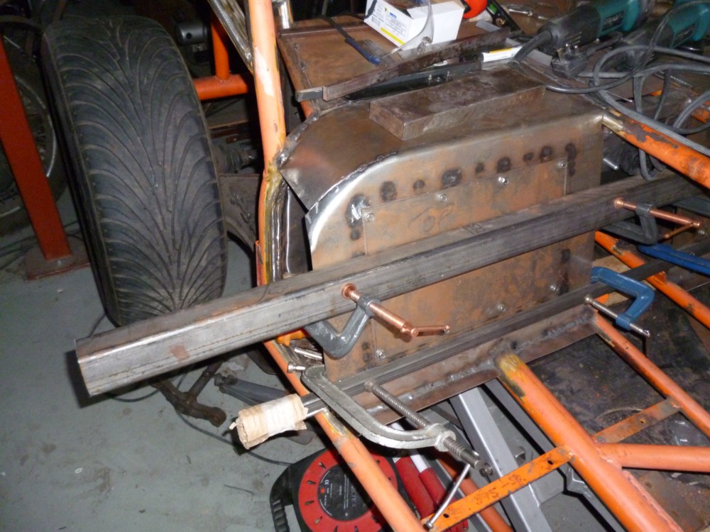

One of our long-term projects is Tilly-the-Trike, this is a 2000cc Ford motor on autobox and the owner asked for some old skool metal body work, here's a couple of pics...

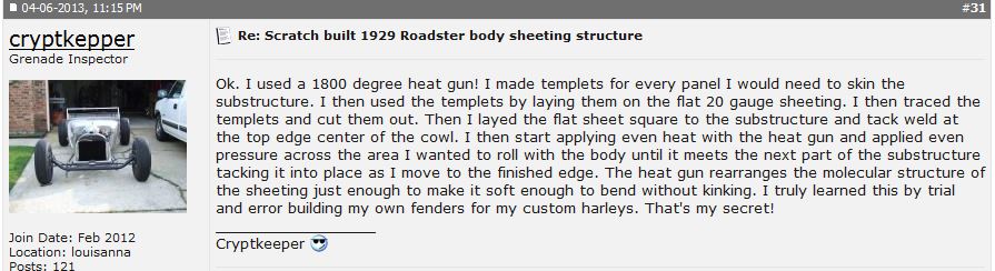

heatgun
heatgun
Last edited by hansgoudzwaard on Sun Dec 22, 2013 3:20 am, edited 1 time in total.
Re: Hot rod style trike bodywork
Did not want to hijack the thread, but the heat gun use seems unique.
