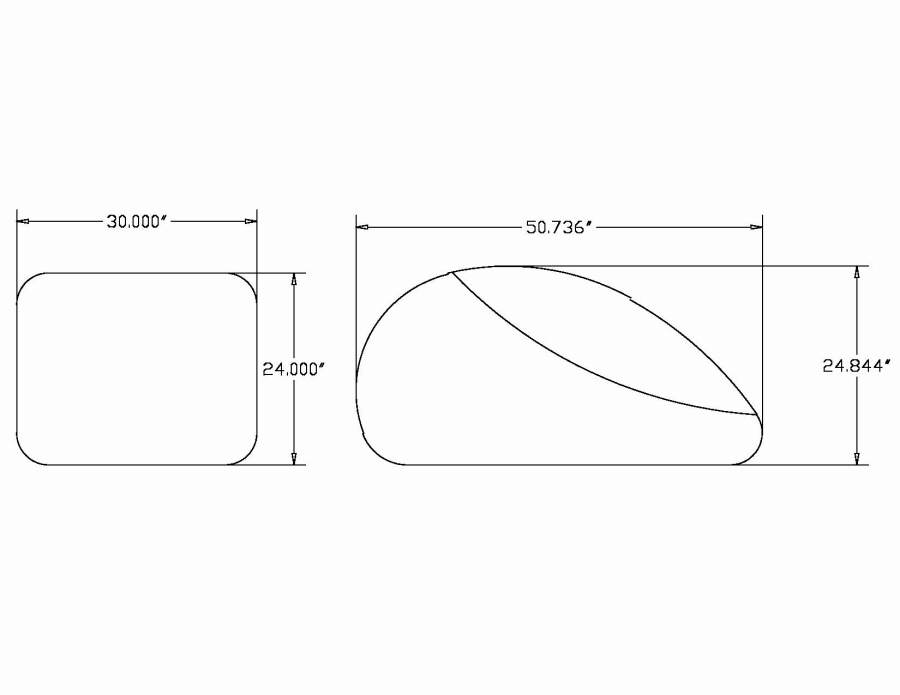

This is what I'm working towards.I think it's butt ugly. This is what they want.
- prelim Model (1.jpg (29.59 KiB) Viewed 20887 times

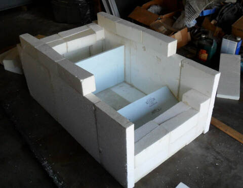

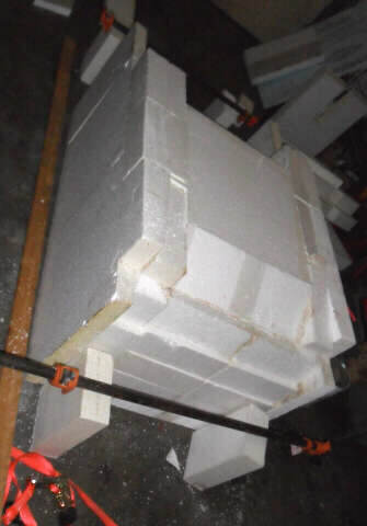

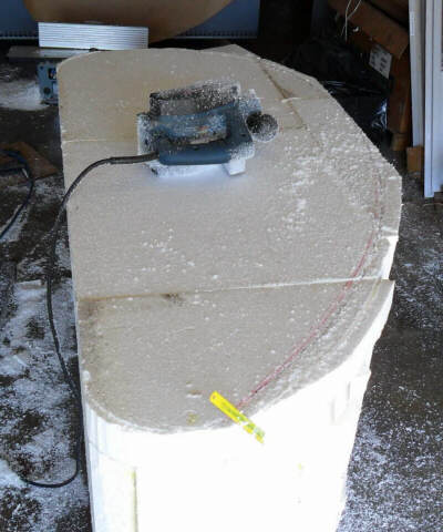

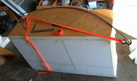

The Buck
This is how the scary start looked. I drew an outline to lay the blocks but some sagging became a problem. Dowels would have helped

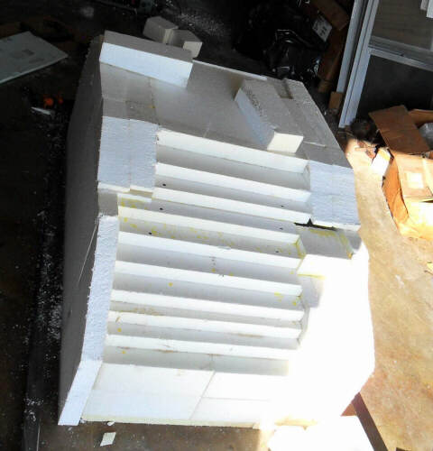

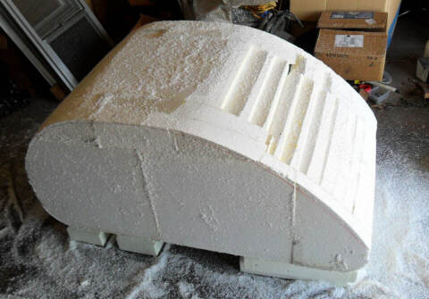

Good News - Bad News
The good news is that foam dust comes off pretty easy. The bad news is that there are some places of the body you really don't want to put an air hose.
This has gone pretty well. Most of my fears are not as bad as expected. I may need to add more foam to the back to fill in the sagged foam or I may change the shape to suite. My homemade radius gage worked real well to arch the back.
Thank goodness I found my hand plane. Thanx Bob Villa for making me buy all those tools when I didn't need them. That power plane is the shit for shaping the foam. I'm contouring the sides and working the middle with a straight edge wich also happens to double as a radius gage.

Re: Urgent Help with Fiberglass
Thanx for the encouragement. I'll have more pics in a few days when I crash again. I've got some hands coming this morning to do the running around. I've put over 200mi on the bike just checking on things.
I filled in the voids and finished the profile. I was hoping to be finished shaping last night, but I'm starting to slow down. I did some thinking on the lip design for the hatch and it won't work. The design was just like the trunk lid on a car. I may just go with a 90* lip to strengthen and cover the weather stripping.
The time crunch will be felt today.

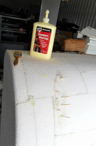

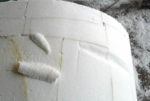

AAARRGH!!!
Thanx for the kudos. But, just when you get comfortable, power tools will bite you in the ass.
Dont even try a DA. I've had good luck with an electric hand plane and electric palm sander. To get the flat contour, an air file was working real well untill the paper caught the foam and cut it like butter. If you use one use adhesive on the paper.
A handy tool for foam bondo is wood glue, toothpics and foam dust. I've been filling voids like this and moving to a different area until it dries. The foam I'm using is ordinary white ball foam and works real nice with "gentle" persuasion. Get in a hurry and it will not let you forget it.
The surface is coming out nicer than I expected. I just heard that 36 yards of 23oz fiberglass will be donated to the cause. That's sweet. Well back to making he flat surfaces flat and the curves curved.

It's a beutifull day in the...
Vinyl Spackling and sheetrock mud are my new best friends. It dries quick with a fan and sands soooo much nicer than foam. I had finished the final shape but still wasn't happy with it. The less work I do now the more work I'll have to do in glass. Voids, cracks, holes and general imperfect shape will be worked out with mud prior to applying a latex paint to seal the core.
I finally got someone to come by with 18 yards of donated fiberglass. It was random strand and only good for the 1st layer, so, I got another 18 yards of woven cloth coming tomorrow. She's a girl and very good at getting her way. I got half a dozen people coming tomorrow. One is donating the tires. One will help me with the hatch and overall design. We get the paint and sundries. Others will track down the hinges and latch. Bikers ain't such bad people after all.
One more good coat of mud and I'm gonna get some sleep. The glue realy doesn't sand well against the foam and ends up being a high spot. Mud = bondo for foam..
