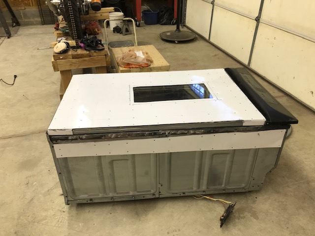

I picked up a double wall oven cheap, so I thought that I would cut the middle out to make a single bigger oven.this is where I’m at now. I have the one element under the floor & will replace the top broiler element for the baking element that was under the floor for the top .Repacked the walls with insulation & sheet metaled the walls shut.I need to bend 2 pieces to wrap around the front, reinstall the seals, make some duct for the fan to get the air moving to the bottom of oven, & whenever I can get to my metal supply, I can get material to make the door. I gonna take the original doors apart to see if I can use the windows in the new door. Well see how it goes.

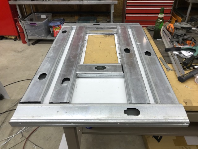

Got the frame for the door built & the inside skinned. Hole for the window is cut. Didn’t order enough seal, so I’ll wait to put the 2 windows in until it gets here. The studs & empty areas will be filled with insulation.

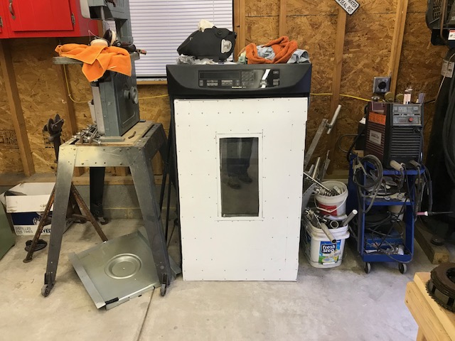

Door is skinned. I took 2 of the tempered windows from the oven & installed them in the new door. A little air space between the two will help heat lose. The rest of the stuff I needed to cut off is done. The door wound up much heavier than I planned, so I hope the couple strips Of sheet metal left over that I riveted to the sides help stiffen the whole thing up. Need to pick up longer rivets then I can hinge the door, handle & locks.

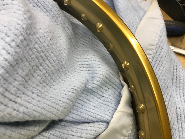

1st part out of the oven since the mod. Translucent brass over super chrome. The chrome was a real bitch to use, so think I’m gonna try a different brand. I am happy with the color of the brass.

That's excellent! Have you tried Prismatic Powders?
Re: Modifying a double oven
Posted: Wed Sep 30, 2020 2:55 pm
by Jeff L
The super chrome is prismatic...translucent brass is Columbia coatings.

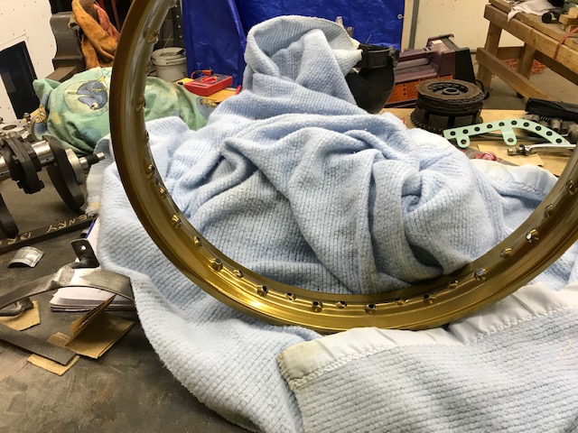

did you lace those babies up yourself
Posted: Wed Jun 01, 2022 9:15 pm
by Jeff L
I did. Took me couple days but I got it done. I had taken pics of both sides before I took the wheels apart so I could see what the pattern was.
