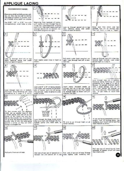

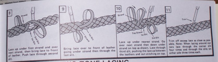

just wanted to welcome any one that wanted to make a seat....will try to help as much as possible...won't cost ya nothing !
A little braiding to get ya started....get cheaper supplies at your local BSA store !
