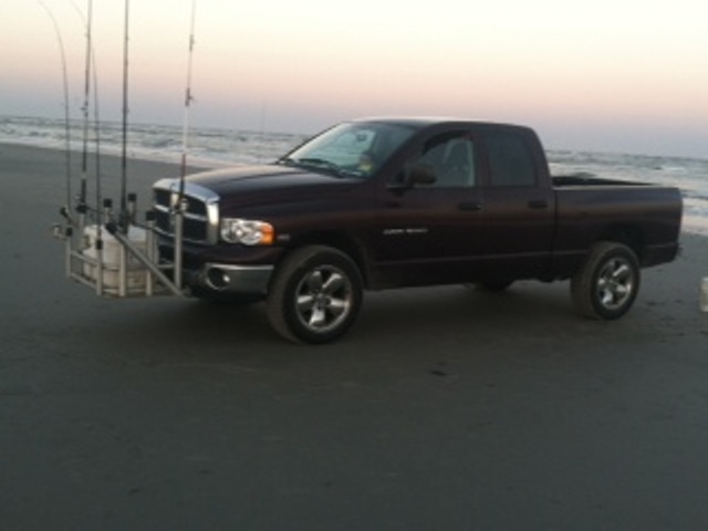

Re: Opinion needed
This is what the Cooler Rack looks likeThere is 30" between tubes that slide in the Mounts....I cut the Mounts apart & redesigned them.This is what I came up with
