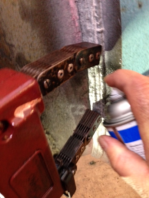

This shows the spray can and the brush. I usually just spray some pt into the cap and dip the brush in it.

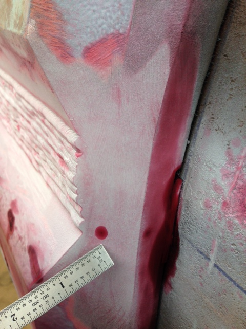

This red spot is pinhole porosity. Very minor, but it will be repaired. There is another on the end of the tee. These are both located where the run-off tab was removed and the area smoothed.
This is an example of the capillary action of the PT, and a non-relevant indication. The vertical dark red stripes are at the backing strip used behind the horizontal weld. This area will be welded tomorrow.

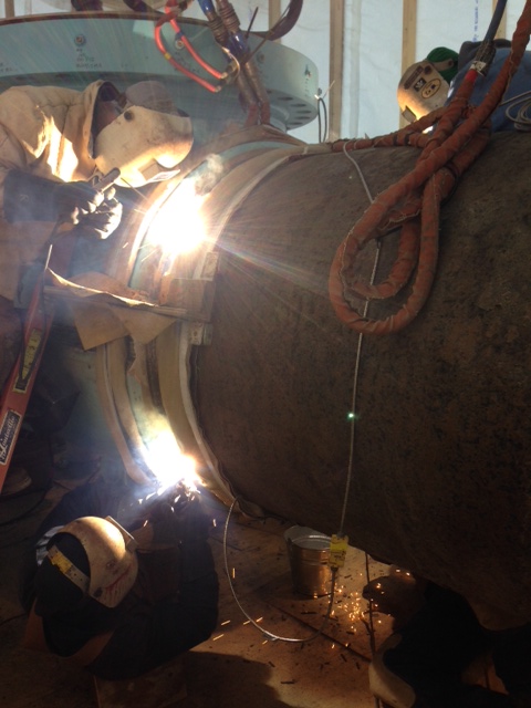

I'll post a few pix of the welding activity on the girth weld. This is a fillet weld joining a 48"x48" split tee to a 48" pipeline while crude oil is flowing.
The oil is about 55F, so it removes heat from the operation continually. To mitigate that, Miller inductive heating is utilized, using tubes wrapped around the circumference, and placed within a few inches of the weld area. This falls under DOT regulation, so the Welding Engineers require continuous inspection while welding. The welding procedure calls for using 4 welders, one on each quadrant. The minimum preheat on the pipe is 86F and on the Tee is 150F, and 8018 electrodes.
The WPS has ranges allowed for essential variables, the most important being electrode diameter, volts, amps, travel speed and heat input.
The inspectors are required to observe the entire process and document significant readings and changes, and approval or rejection.
There's a lot more to it, but thats a pretty good intro.

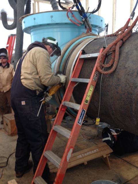

This shows one welder working on the upper quadrant. Below his elbow is a flat board with fire balnket. Its attached to the pipe with magnets and keeps the lower welder from getting fried. In the center is the vertical weld, with the Miller heat wrapped around the pipe.
This shows both welders on one side of the pipe
You can see all 4 welders in this one. It's pretty cool to see these guys work together. All professional, no drama, easy going.
Fitter running 9" wire wheel after each pass. Another fitter on the other side. These guys are kept busy adjusting amps and handing rod to the welder, cleaning all the time.

This project requires either fluorescent or black on white "wet" mag (mag is short for Magnetic Particle).
Fluorescent can be a real pain, you obviously need darkness, so you have to use a cover to keep ambient light out, use a blacklight which has to warm up, and is very sensitive to knocks. We used black on white, which is done in white light, ambient or artificial, with a minimum of 100 foot candles of brightness.

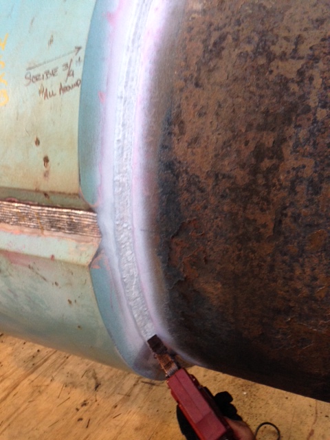

Black on white refers to the white paint sprayed onto the weld, and another substance sprayed over the dry white paint. The second spray has black particles suspended in a oil-based solution. An inspection tool called a yoke is used to apply a magnetic field into the weld and base metal, and while the field is in the metal, the black spray is applied. Any indications appear as a black line that shows up against the white contrasting background color.
This shows the weld after applying the white contrast paint.
Close up of the white on weld
Clear shot of the yoke in place
This is the yoke holding the mag field and black spray applied. Had a hard time showing the black spray on the weld, but you can see the white paint thru it, and the black tends to follow the valleys between the passes, and gathers at anomalies in the cover pass, like starts and stops, undercut between passes, etc. The spray is applied between the legs of the yoke fairly heavy, but too much is not good, it might mask an indication.
Almost forgot, the magnetic field is induced twice for each area, the second time at right angle to the previous time. An indication might not be revealed in one direction, but could show up in the second test, due to orientation in the metal of the inclusion and the magnetic flux field.
The yoke has adjustable legs that bend and can be spread to whatever width you need to fit an item.
This one is a DA-400 and can use DC or AC. Each is better suited for different applications, but DC is known to penetrate deeper and can find indications or inclusions as deep as 0.050" deep. Technicians have to be tested before being certified to operate them.
