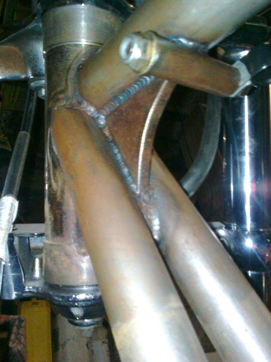

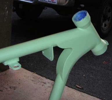

I cann't see the other pic, but understand what you're saying about the stress going through the straight line.
Re: Where to have welds tested?
Maybe this will work.
- Posts: 696
Yes it did Hans...Nice color too.

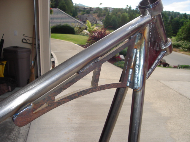

Is that your frame Hans?
anyway I'll show whats on mine.
- Photo0237.jpg (96.04 KiB) Viewed 19467 times
- Photo0236.jpg (47.46 KiB) Viewed 19467 times

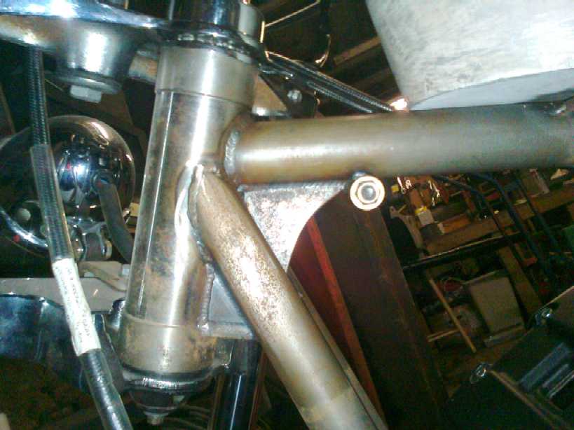

Naw Max;
It was from a build on CW.
This one is mine.
This one is mine.

max those welds look nice and hans i really like the design of that brace . watterjet?
It is.curt wrote: watterjet?
I saw something similar online, drew it out to my size, rake, etc., my son made a dxf file for it.
The neck area gusseting is similar to what Gary W. recommended in his CD.
