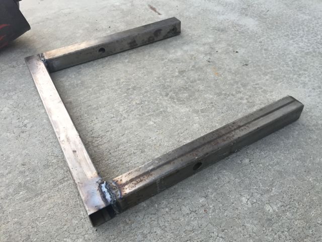

you start with some 3 or 4 inch square tubing. i cut 2 pieces 16" long, 1 piece 19" long, and 2 pieces about 15" long, then bevelled and cleaned up the edges for welding.

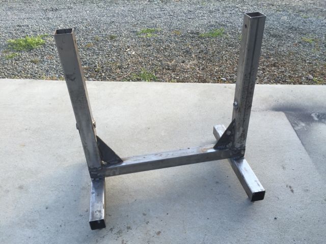

next, i welded the two upright pieces (the 16" long pieces) to the bottom piece (the 19" piece) to form a U shape.

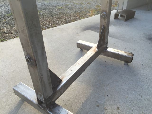

then i welded some nuts in the 15" pieces i'll use for the feet,
and then welded the feet to the bottom of the U shaped piece, welded in some threaded bungs, and some gussets for strength.

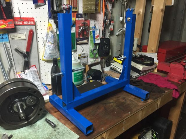

add some skateboard bearings and of course a little paint to spruce it up, and we're all ready to use it.
