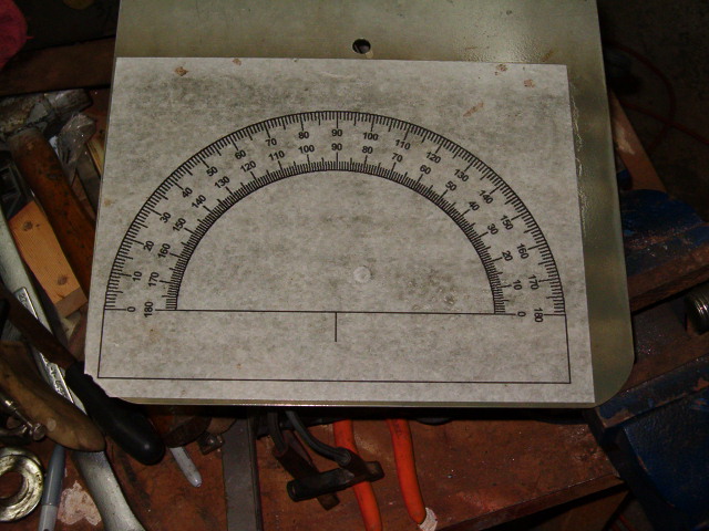

For anyone doing their own JD style bender a DIY bend angle guide. Used a chunk of aluminum sheet, a coat of clear lacquer, smooth the printed sheet onto the lacquer, let set up, 2 or 3 sealing coats of clear with time to be almost touch dry between coats.
A positive and negative view of a printable protractor attached.
printed copy using clear lacquer as the adhesive and protectant coating

Re: Printable protractor for CBH/JD bender
#60 degree timming wheel... can be used for any type of protractor !
osp-degreewheel.pdf
360 timing wheel that can be used for anything over 180 degrees
(267.87 KiB) Downloaded 851 times

Thanks, this is exactly what i needed. this message board is fantastic.

Excellent post!!!
yona wrote:#60 degree timming wheel... can be used for any type of protractor !
Yona, thanks for the degree wheel. Will be handy.
