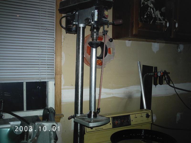

I use this mainly to get Aluminum tubing ready for the buffer, but it works well to use to prep your tubing used for frames & whatnot.I like to clean up all the tubing before I work with it & this makes it easy.I had a bench top drill press laying around, so I fit it to a 6' section of stainless the same diameter as the original post.Put a live center in the table, & used a bow roller off a boat trailer cut it in half, ran a bolt through it & chucked it in the drill.Heres a pic with a length of tube chucked up.Hope someone will find this usefull.

Just a note....If you go as high as mine At 6' high the base is to small.(itll be real top heavy)You'll have to make it wider.
