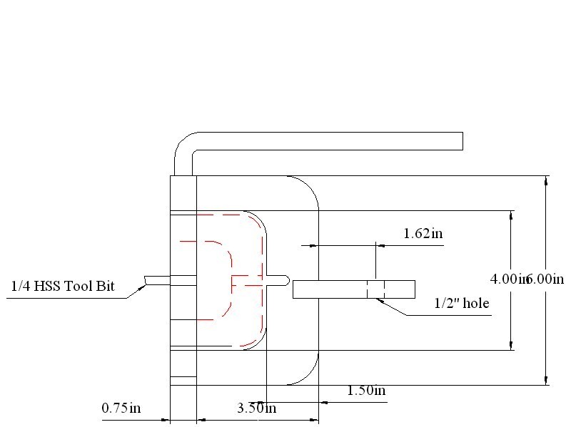

anyone got plans for a radius tool for the lathe or mabey a couple good pics

Here's one on C/W that Mechworks posted. Quite a few pics and a drawing or two.
http://chopperweb.info/forum/showthread ... eadid=8763

Very neat little toolpost ball turner. http://www.projectsinmetal.com/free-met ... athe-mill/ Several other projects on this site.

Wasn't able to view MechWerks but here are a couple others. I had the dimensions of the OMW and was going to make it a couple years ago - who knows where the hell they are now becasue I can't find...
http://lepton.com/metal/ball_turner.html
http://www.frets.com/homeshoptech/TechL ... adius.html
http://littlemachineshop.com/Instructio ... ctions.pdf

Some of this might be what Jim posted....just put up all that I had plucked from the internet...
dirty rt-radius cutter.jpg (37.51 KiB) Viewed 26918 times
BALL_TURNING_TOOLPOST.pdf
(45.89 KiB) Downloaded 870 times
BALL_TURNING_TOOL_HOLDER.pdf
(43.52 KiB) Downloaded 914 times
BALL_TURNING_ROTATING_BODY.pdf
(76.96 KiB) Downloaded 1111 times
BALL_TURNING_HOLD_DOWN_BASE.pdf
(65.34 KiB) Downloaded 938 times
BALL_TURNING_BIT_CLAMP.pdf
(38.49 KiB) Downloaded 1011 times
Re: radius tool
Instructions and picture
Thought I had a good pic...
RADIUS CUTTER.jpg (23.27 KiB) Viewed 26860 times
Instructions for Radius cutter.doc
(20.5 KiB) Downloaded 1130 times
