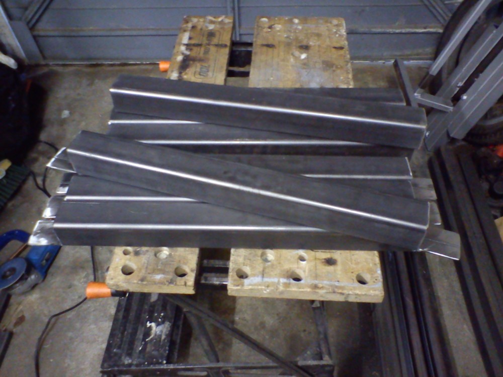

It started off like this
Bike Lift 001.jpg (137.65 KiB) Viewed 43139 times
and quickly progressed to this

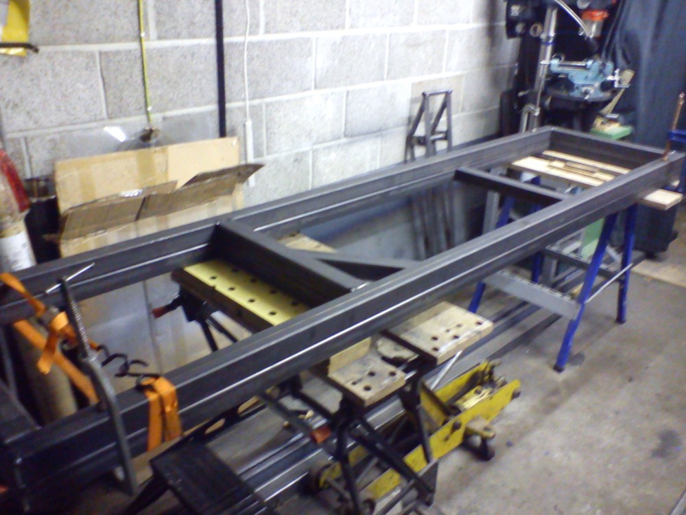

then it got all welded up
Bike Lift 006.jpg (134.11 KiB) Viewed 43139 times

as you can see I originally designed it to be operated using a trolley jack - a 2 tonne jack will easily lift a full size motorcycle...

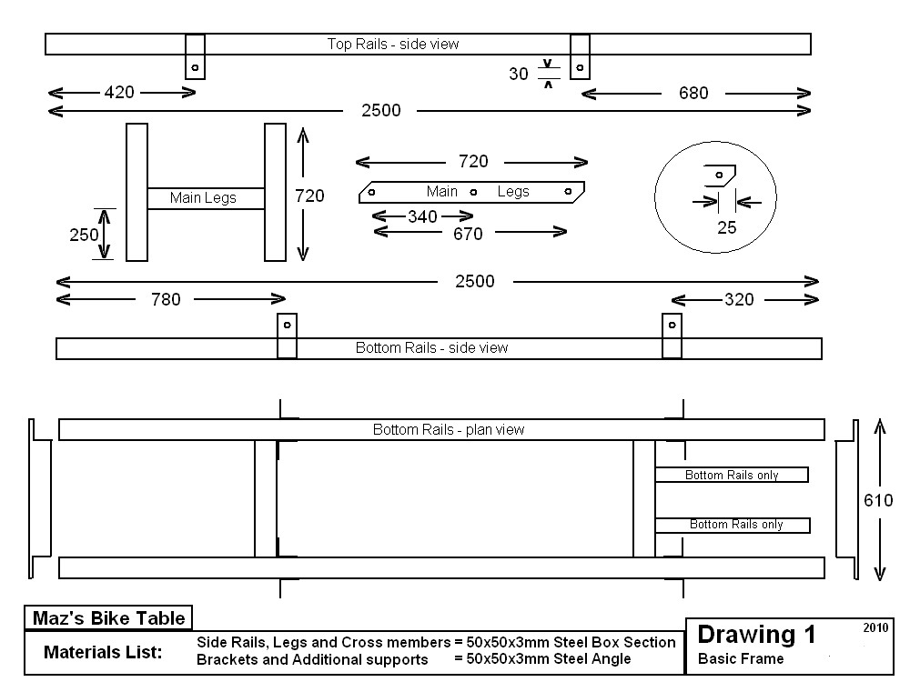

Sorry guys, I forgot to post the plans :doh:
bike table plan 01.jpg (101.21 KiB) Viewed 42950 times
I do have a full CAD drawing saved somewhere but meantime here is a basic drawing - you either need to make the trolley jack part on the base to fit whatever jack you have or you can mount an air/hydraulic ram in the middle instead......
Hope this helps :banana-dance:
