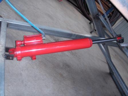

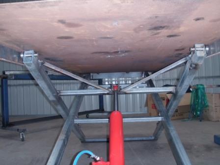

Hello, Its been a long time between posts and actually having something to contribute. :popcorn: After some long research and viewing all of the other posts across different sites and visiting and talking to some Harley shops i have finally come up with my version.
Stats
3m long x 1m wide 75mm sides 25mm return x 4mm thick
75mm x 50mm legs
2 old trolley jack wheels
16mm scissor pivot pins
16mm rear fixed pivot pins
20mm top bearing shafts
8t Air Hydraulic ram $150
Extension leg from Caravan for Tyre vice
Pesty
Ram area, not happy with this setup as it wants to twist the tube towards the top, will replace with 12mm plate over a wider area to minimize force.

8t Air over Hydraulic ram $150
View from other end
View from other end

Close up of 8t ram and fixture
Re: Pesty's lift Table
Hello pesty, table looks real good you did a nice job building it. Should work real good for you, i made mine from heavy duty wood which makes it real heavy but works real well. I made it to the height that was best to work on it with no need to have to use any jacks or rams to raise or lower it, may not look real pretty but functional. All i need is my ramp to roll my bikes up on it and tie them down with ratchet straps. :D :auto-biker:
Very nice....
I like that design - I almost built mine that way but in the end went for the heavier frame type as it suited my needs better. I will have a go at building a scissor type when I do the next one. Great job dude :clap:
