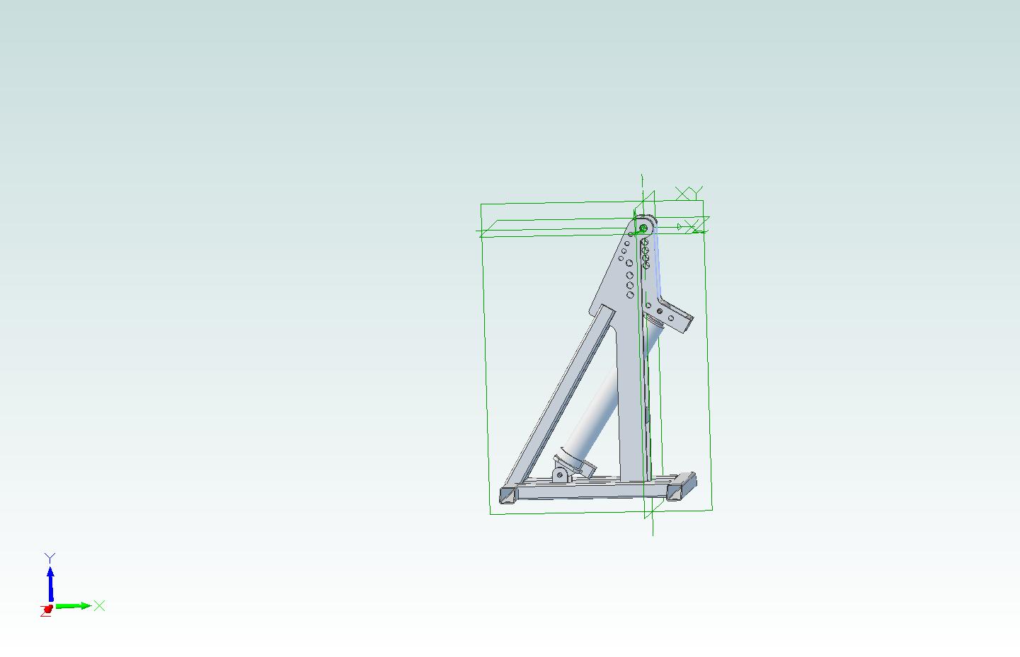

My son and I are building a tube bender to facilitate an SCCA cage fab. We will be using JD2 M32 dies for this project. We need the hole location dimensions for the back block pivots in the main frame which are 1 1/4 inch diameter. This bender is an upgrade to the CBH design to use the Model32 dies.

Here is what we are working on.
Vertical Bender
Vertical Bender

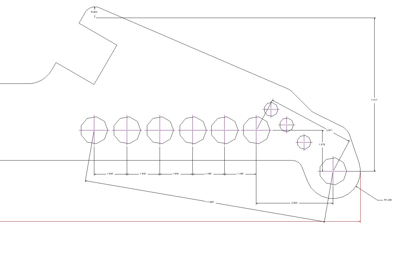

Thank you for your reply. I need the position of the 1 1/4" diameter holes in relation to the main pivot hole.
1) distance that the holes are offset
2) distance down to the first hole
3) distance down to the last hole
Your help is greatly appreciated

This should be what you need?
The offset should be able to be calculated knowing the holes sizes?
If you could can you please make your bender prints available here for others?
And we would love to see build pictures of the bender?
Holes in the arm Distance of holes 1.25 offset.
hole
1-2 = 1.45in
2-3 = 1.45in
3-4 = 1.50 in
4-5 = 1.50in
5-6 = 1.50in
6-7 = 1.50in
Total length of holes along the arm= 7.400
Measured the arc of the circle off the pivot hole to first hole in arm and measured = 3.950
Measured to the edge of the arm to the edges of the holes .
To the arm holes from edge add half the hole size to this. .625
Subtract half the hole size from this. Add the 2 together you will have the off set. With the radius of arc measurement should be able to do trig to get it offset the other way.
You need it measured any other way just ask.

Using what you gave me this is what I have.

There is 7 position holes in the arm your print only has 6?
I double checked it the print looks right?
You want i can do out side to out side measurements moving the pins around?

5.20 - 1.25 = 3.95
The offset must be off in the print causing the .020 difference?

Could you please measure over the last hole and the pivot pin.

This has to be what it is.
direct link to image
http://i.imgur.com/AtLFe4gl.png
if you need the cad file i can get a link for you?
