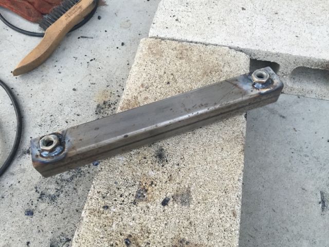

then i welded some nuts in the 15" pieces i'll use for the feet,
and then welded the feet to the bottom of the U shaped piece, welded in some threaded bungs, and some gussets for strength.
