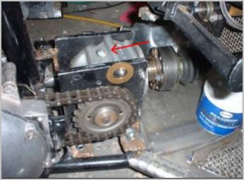

home brew right angle drive

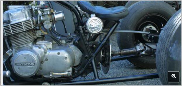

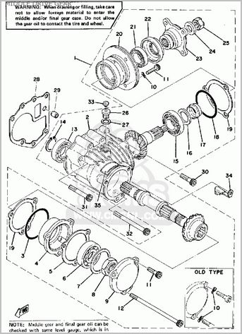

On "CW" , BlackJack made mention of a "Yamaha middle box" in trike discussion on the forum.
I searched , found these images utilizing that piece. This may be more compact than the homebrew alternative.

That would depend a lot on the machinist carving out the houseing , you can over engineer anything !

It seems to stand up to V-MAX use/abuse.
