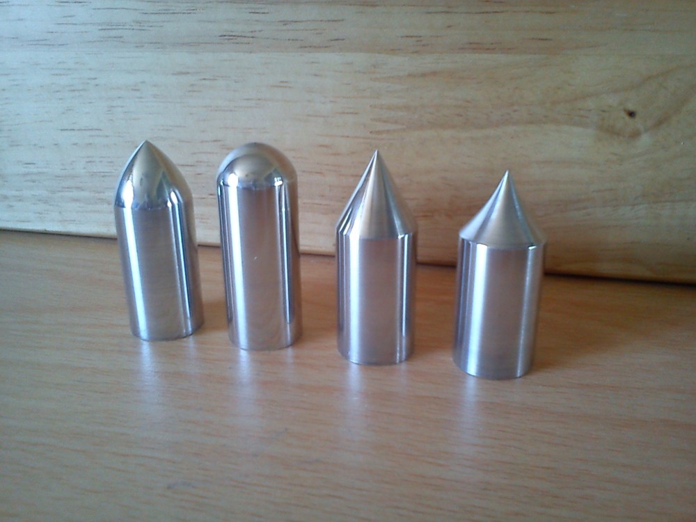

I never finished my post on the old forum about the large radius tool we made for my lathe....
Here's a selection of thread finishers made using it....
MazChopz Sylver Bullet 008.jpg (118.82 KiB) Viewed 23978 times
I don't have any detailed drawings at the moment but I do have a lot of pics if anyone is interested.....

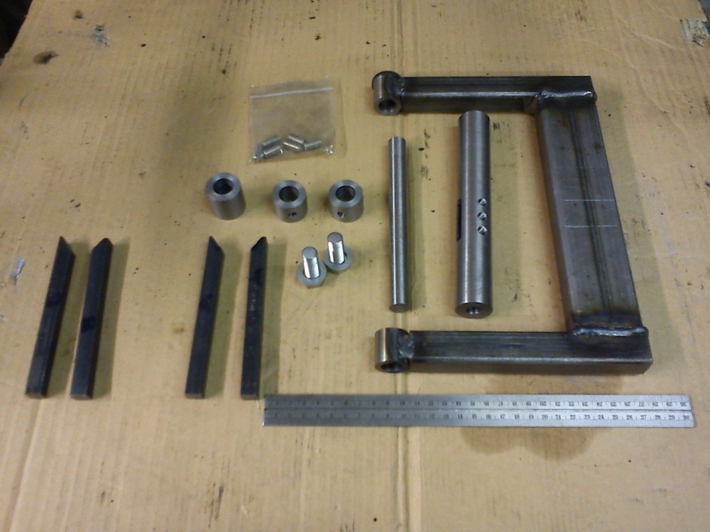

I may or not post my "nurse" pics but here's some details of the large radius tool build..... :snooty:
This tool is designed to be reversible and also to have a larger swing than conventional radius tool designs. For this reason it is fabricated rather than cut from solid steel and has a supporting plate that clamps onto the lathe bed....
I won't give dimensions or plans cos it needs to be made to fit your own lathe.....
Here's the main components...
RT 004.jpg (128.22 KiB) Viewed 23905 times

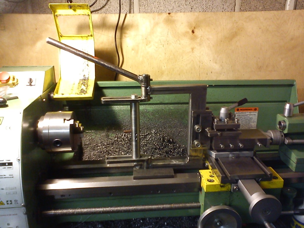

Here's a side shot showing the fully adjustable mounting into the tool post....
RT 008.jpg (170.4 KiB) Viewed 23905 times
