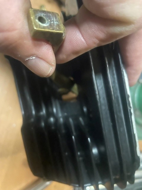

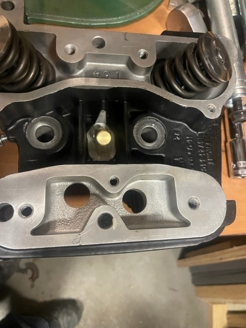

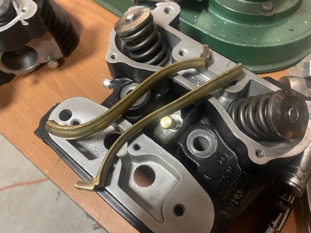

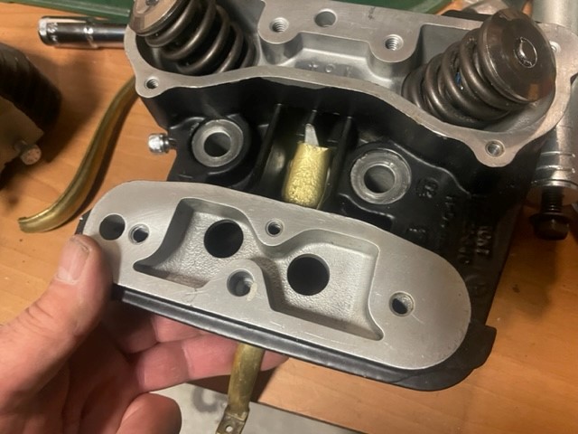

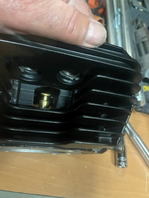

A few pix of the heads…
The order is reversed but they show the compression release from top and side, the material I’m considering for levers, and the position for operating the lever and release. I think the levers are from part of a light fixture, some scrap laying around.
Soft enough to bend and shape. I want to have an inverted cup shape above the releases and make a hinge that will mount to the underside of the head fin. Haven’t worked that out yet.

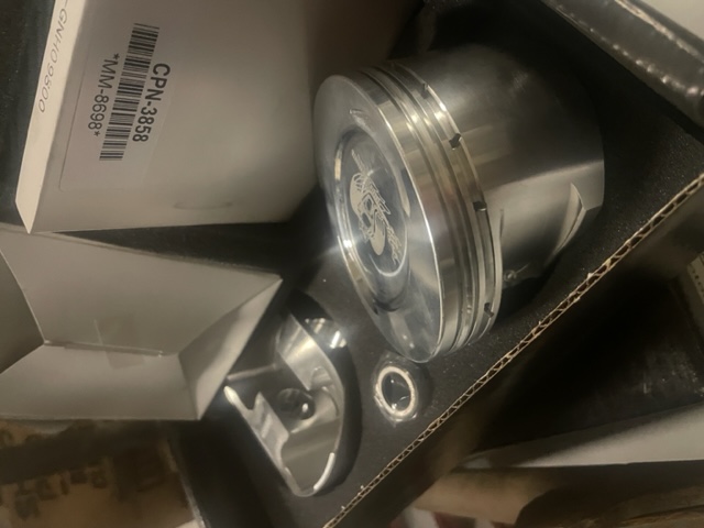

New pistons from CP

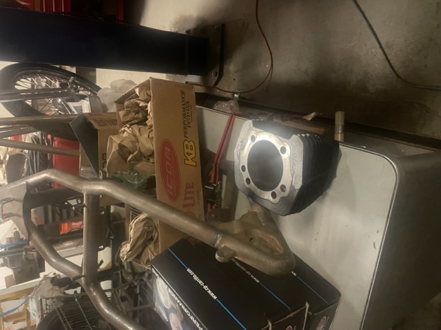

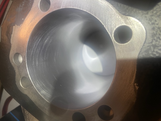

Picked up my cylinders from the local machine shop. One of several here. It's a new business started last year, but I've know the owner about 10 years. One of the finest welders I've ever met.

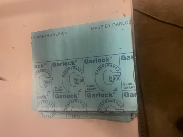

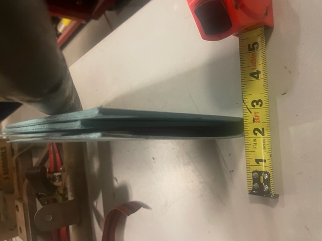

This is the Garlock gasket material I mentioned in an earlier post. I'll use the thinner which is right at 1/16". These are about 6"x6" so I should have plenty to trim to size, as long as I don't screw up.

Thanks for the Garlock reference. Seems like a superior product.

Thanks, great info. I watched the vid, now I'm shopping!!!hansgoudzwaard wrote: ↑Thu Jul 13, 2023 2:43 am Thanks for the Garlock reference. Seems like a superior product.

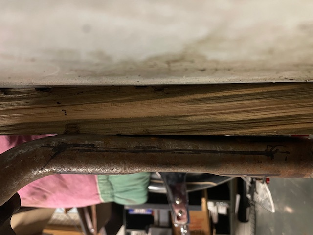

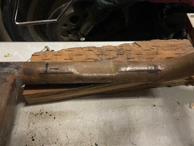

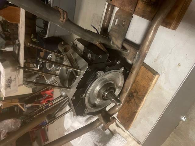

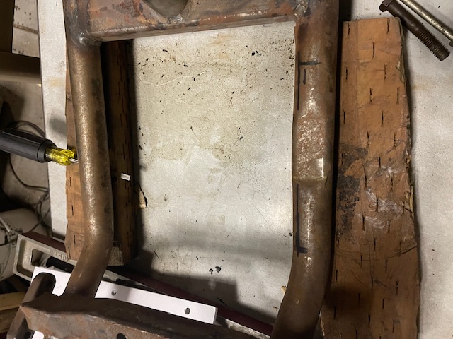

Well, I did place the bottom end in the frame. The Delkron case has a square inspection plate on the bottom and the left side contacts the frame tube by about half a bolt hole, which prohibits installing bolts in the motor mounts. I think I can remove part of the frame tube, the upper inner quadrant a little longer than the case bottom. If I do it carefully, I can flip that piece so it becomes concave and weld it back to cover the tube cavity. Same material, thickness, etc.

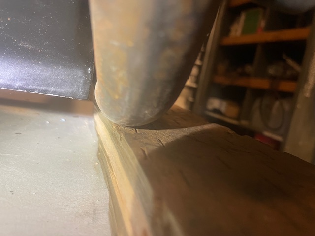

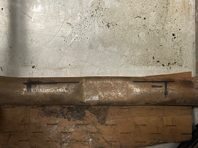

My engine has Delkron cases with a square inspection opening and cover plate on the bottom. It's a little wider than stock cases so it contacts the left bottom frame rail. With the engine in the Santee frame there is about a half hole of misalignment for the front and rear mount holes. I marked the frame at contact points. I'm considering different approaches. I pulled all parts of the frame and will take it into my friends machine shop and see what he recommends.
In the top view the tube from the sharpie line to the inside is in the way. The marks across the top mark the front and rear edges of the case. The case does NOT sit on top of the frame.
The sharpie line on the bottom inside running front to back is the bottom of the case WITHOUT the cover. I realized it after I pulled the engine out. So that line should be another 1/4 to 3/8" lower which puts it right at the bottom of the rail.
Right now I'm thinking a cut straight down from the top to bottom full length would remove enough material to fit the engine into the frame.
Undecided about how to add strength back into the frame. I considered adding a flat plate into the cavity, or flipping the removed tubing and welding back in (same material and thickness). Thought about coping the ends of the cut to prevent stress risers at intersections of the cuts. Thought about slugging the tube.
Not taking action until I'm comfortable with expected results and the fab method.
I bought a chopper project with this frame 2008. It's pretty heavy. My friend misplaced the MSO (Mfg statement of origin). I checked the rake tonight with my new degree gauge, with bottom rail at zero, the neck comes in at 33 degrees.
And does anyone know why the frame has the flat spot on the bottom left rail?
Thanks, Bob
Thanks, Bob
