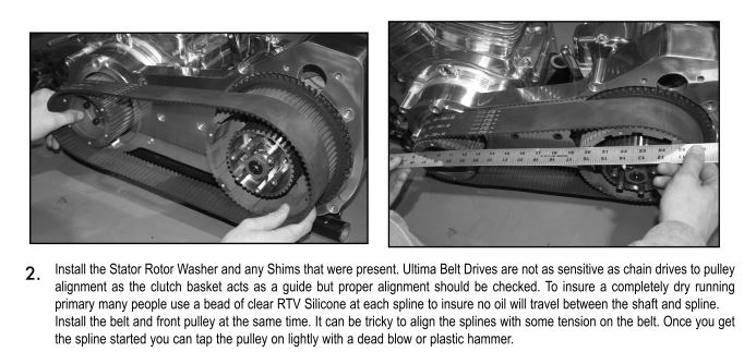

Sounds like you are doing OK.
As long as your engine/trany / motorplate faces are in plane with each other and with your rear wheel sprocket , you should be fine.
I am posting the belt drive picture to illustrate the alignment check, Yours would be on the other side of course.
