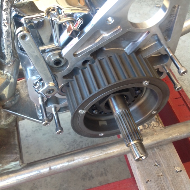

INSTALL A OPEN PRIMARY BELT DRIVE.....
Like it says above.
Re: INSTALL A OPEN PRIMARY BELT DRIVE.....
Good oil pressure, and was an easy start.
https://vimeo.com/167203546
I have pulled it apart to get on with the rest of this build.

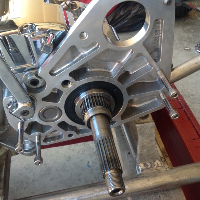

Determined that the belt drive would not work in the 140 frame.
The transmission came with a belt drive hub/sprocket.
Took it off yesterday, and am ordering a chain steup for this bike.
Had to remove the inner primary, but left all else in place.
I will use a 51 tooth rear sprocket I borrowed for mockup to set up the chain drive.
