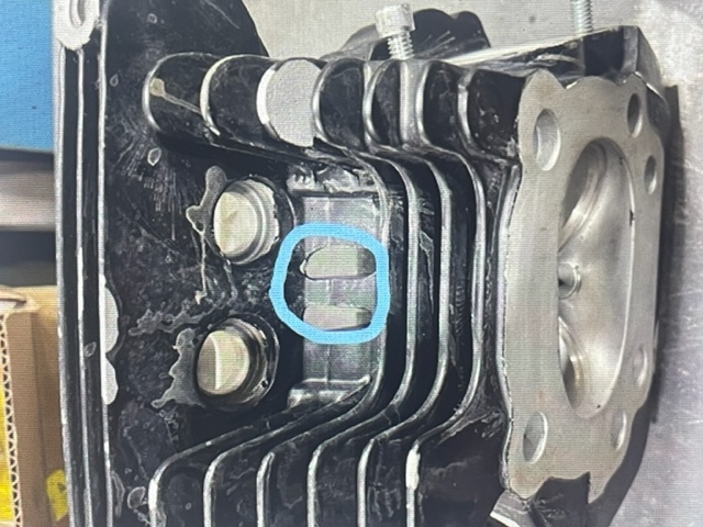

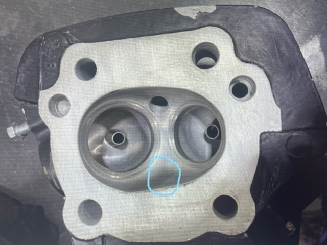

These are single plug heads with reshaped combustion chambers. I marked the optimal location inside the chamber.
CR Location Inside.jpg (114.62 KiB) Viewed 31155 times
The next pic shows where I think the release would be located on the top of the head.
marked head.jpg (132.73 KiB) Viewed 31155 times

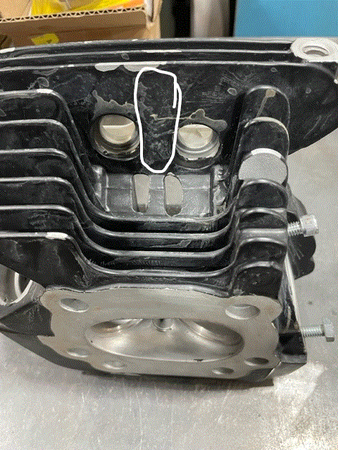

Next shot shows the center fin that would need to be removed.
Center Fin.jpg (125.81 KiB) Viewed 31155 times

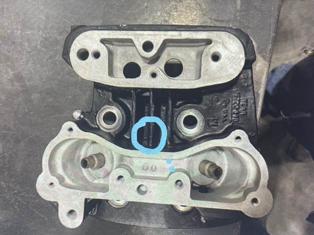

Next is a view of the right side. I think the middle vertical riser could be removed to make room for a mechanical lever.
I'm thinking the lever could have a simple pin hinge mounted on the underside of the bottom head fin. Push it upward to move the release down to actuate it. The lever would extend out from between the pushrod covers.
RT Side.jpg (156.12 KiB) Viewed 31155 times
The lever would have to be fairly long to reach. Heads are at machinists, so I can't measure right now. I might need to rethink the mount point to take advantage of the leverage.

Went by the machine shop yesterday. Put my hands on the heads.
In the last photo above showing the side of the head, with the vertical riser marked.
That is actually the same center fin on the top, not a separate riser.

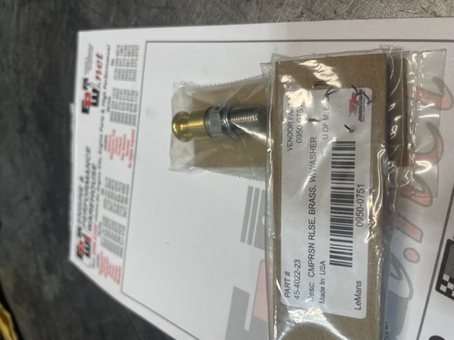

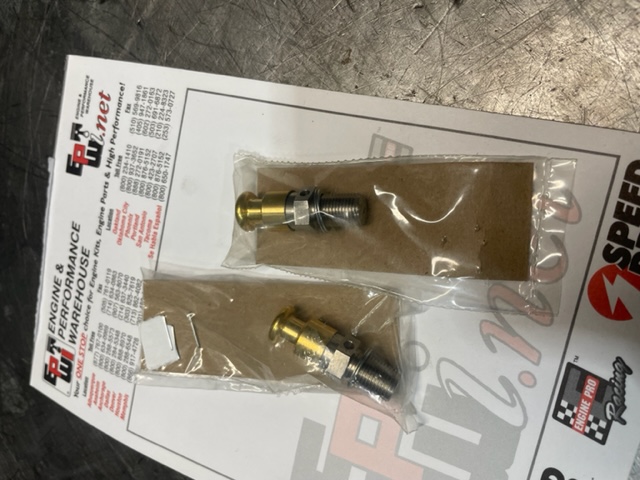

I've ordered compression releases.
The machinist tells me no prob to remove the center fin and drill and thread a new hole for the release.
I'll work out some kind of lever to operate the release. It will be accessible thru the center hole in the rocker covers, but it won't be easy to reach. That hole is beneath the tank and backbone, too hard to reach in.
I think I can mount a hinge pin on the bottom of the finned area, between the pushrods.

Received the compression releases today, took in to machine shop.
They will modify heads and install.

Also, the diameter of the CR cap is 0.510, so I'll be looking for a larger cap to fit over that, to use for a lever system to operate the release.
