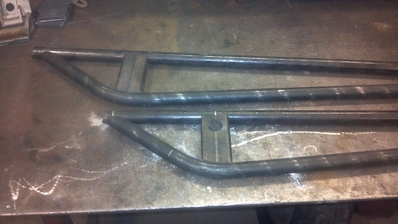

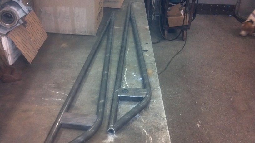

Re: curts girder build

pics from the other day i got everything fitting nice couldnt weld anything cause i didnt have time to get the new annular bit to drill the hole hoping for tomorrow
Thats some lovely work there Curt.....how you getting such a close fit?

Maxthegardener wrote:Thats some lovely work there Curt.....how you getting such a close fit?
i take a marker and color the end of the tube then slide a piece of sandpaper between the two and pull the paper out whatever is shiney needs more sanding repeat a few hundrid times and your there .lol i think springers are easier more parts but easier

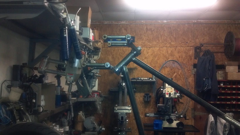

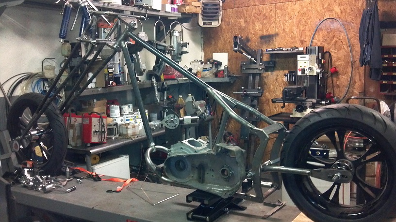

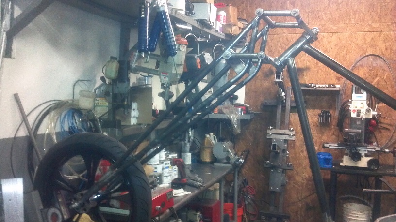

everything tacked together today starting too look like something
krymis wrote:curt you are doing a great job. is this girder going on the same frame as the springer? that is actually how i started making all the frontend. I built one prototype frame and built a springer first. then i built a girder. i then had to wait a while build another frame and built a leafer. the first frame came back when i built my first harman. Now i have one of each to show the customers as they come over. keep up the good job.
no the girder is going on the softail frame in the pics the springer is going on a hardtail i built on the old board ill be posting it again when i start putting it together its in a rolling chassis sittin waitin for me to get futher along with this one

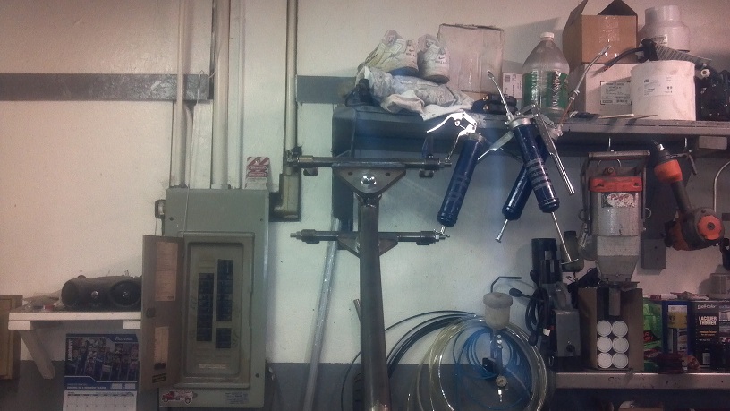

got everything on the girder finish welded today gotta pull front tire so i can make spacers for the wheel and figure out what im going to use for a shock but got it in a rolling chassis anyway
