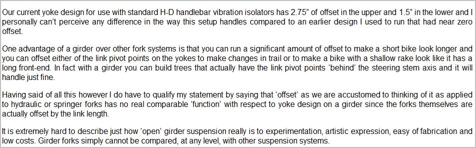

Hi all, for calculating purposes , does a girders link length count as offset?

Re: Girder question
You may need to read this.
http://www.chopperhandbook.com/forks.htm
Re: Girder question
I just scanned through "girders". There may be more on this.
Quote....
Re: Girder question
I've always loved the looks of girder forks over other designs, but never realized the mechanical advantages.
Thanks for the post, I'll have to give that more study.
Gary's last sentence says it all.
