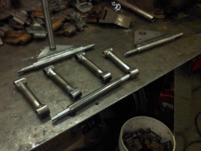

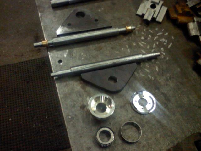

i started a girder build for the softail frame build i really want to buy garys cd but i been spending too much cash on parts for the 2 builds i got going on now and christmas coming itll have to wait a lil while but in the mean time ill do as much as i can from the plans that i got from a nother member (thanks i appreciate it ). i had the dxf files on the frame cd i bought so i went to budys shop and had him cut the trees out for me man gotta love that plasma table took nothing to clean them up . i had some 1 inch cold rolled barstock laying arround in my shop so i cut 2 lengths and turned them down on both ends to 5/8 and then 1/2 instead of the hollow tube and welded bar i saw it done on the old bord and liked the idea i dont remember whose post it was but thanks for the idea . then i made the dogbones at 4and 1/2 inches per plan dimensions.i turned the small pieces down to 1.25 and bored the inside to 3/4 so i could use 3/4 to 5/8 bushings for the pivots and turned down an extra 2 for the wheel axl while i was at it . finaly got tracking numbers for the rims i orderd they should be here tomorrow. the only question i have at this point is how do you figure out how long to make the legs is it the same as a springer get the frame to ride height and use the rim and tire seems the logical way but ive never tryed to build a girder before and the old bord is down so i cant see how anyone else has done it so any help would be great .

finally a little progress i bought the girder cd from bitterend choppers and got it in the mail over the weekend read gary's how too cleared a lot of questions up . gave me a few ideas for the next one too glad someone of his experience and ability is so willing to share info cant thank you enough. i also got the stem back from the machine shop .i turned down the stem so it would fit for height and so i could get the bearings on all they had to do was thread the 1 inch 24 threads for me . i have a lathe that will turn the threads but i dont have and dont know the proper tool to get the threads i have a 60 degree carbide but its too wide for such narrow threads any sugesstions would be great so next time i can do it myself. i also had them cut the 3/4 inch slots for the axl plates im going to use for the softail frame so i can get going on that too . i talked the boss into letting me order a mill for the shop its a cheep import but it should work for anything i might need now got to learn how to use it so i can build bike parts easier lol cool boss.

got a lil progress on the girder today made a stand so i could set the frame at ride height and raised an inch in the front so i could get the length of the legs took the bushings out of the links and put some oversize washers on the pins so i could tighten the nut and lock them in position put a level on em to make sure theyre nice n straight and measured em up cut both tubes and fishmouthed them so theyre both exactly the same . im going to run tube for the axl mount so i fishmouthed that end too.now for the fun part bending the trusses i did one spent about 3 hours makeing it real nice tight fit on the long end with a grinder lil at a time got it real close and decided to take some measurements :angry-cussingblack: :angry-banghead: the bend is too far down the leg . while i was realizein how dumb that was i rememberd the hubs were wider than a stock wheel so i decided to check that too :angry-cussingblack: :angry-cussingblack: :angry-cussingblack: :angry-cussingblack: it appears im going to have to remake the trees too they need to be 12 inches between the pivots not the 8 the plans call for but oh well i got a good set of trees for the next project
but i think springers are easier so well see . more progress soon

Looking good Curt. The first one is always fun. The only other advice I can give ya is that your axle journals that you will weld on to the bottom of the legs will shrink/deform on the ID.
