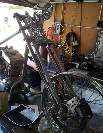

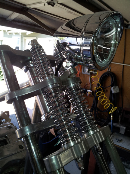

Re: Springer Welding, Need some clarification?
Pictures here! I built and machined everything myself, motor and wheels aside.
now that is real nice work there man it came out real well i like the nice bevel you got on the edges
Thanks, I machined them with a corner rounding bit.
great looking work, there. looks like you got it all figured out quite well.
as far as the spring bridge thing, i wouldn't worry too much about not having it. i ran the springer i built from Gary's plans without one and had no problems at all. of course it may have ridden even better with one, but i loved the way it rode so i didn't mess with it.
