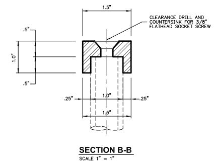

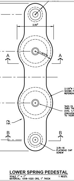

In the spring pedestal on Gary's plans, would it be OK to weld the front legs into section BB ?
I'm looking to simplify but want to keep it strong. I already have this style lower spring pedestal.
WELD HERE
WELD HERE
DRILL THRU @ BB
DRILL THRU @ BB

I would not see a problem welding the pin to the fork tube would actually be stonger than that bolt designed there!
The only possible problem would be if over time that bearing surface of the pin was to become damaged there that you could not easy replace it like the bolted version?
Also if the pin is a hardened material welding it to the fork tube material would take a post and preheat process to not make the material crystalise during the welding process?
A tig welder would remove most of that process because of being able to control the heat better?
the main problem would be not being able to change that pin out if it was damaged over the life of the springer!

in past when using 3/4" trees or thicker i have just bore a blind hole. top tree locks the tubes in place with out a pin or a bolt. now i make my springer so that the handlebar risers clamp the top tree in place. as for the front legs i always weld them in place.

That pin he is talking about is for the rockers right?
You get a good welding procedure and you got no problems actually stronger!

Thanks for the good advice Guys.
It is the 2 areas on the attachment.
weld it.
weld it.

I expected that virtually everybody would come up with their own unique bridge design. There is nothing wrong with making this a completely welded assembly (like they were originally in the old days). This is the least expensive part of the build so why not make several design alternates. I don't think I've ever built two the same anyway and most of the time I just use scrap for the bridge so the design can get pretty rudimentary.

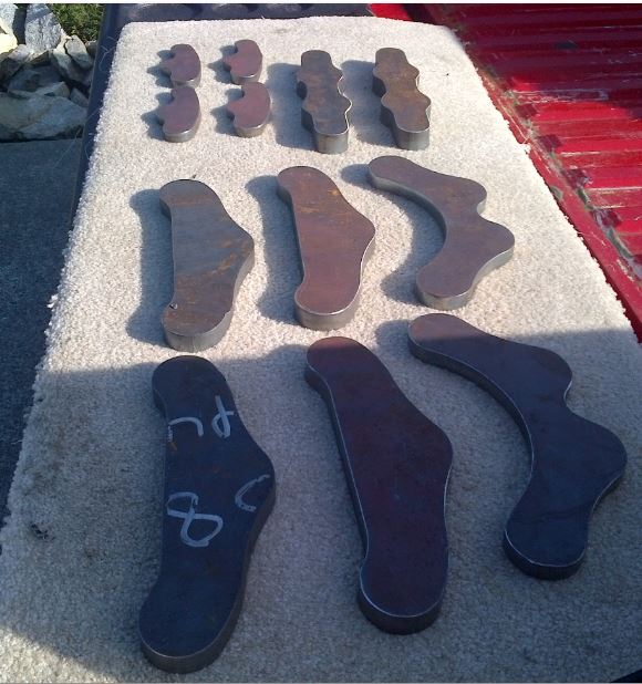

I had two complete sets of springer parts water-jetted, so they get used up first.

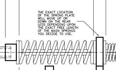

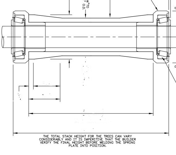

I am at making sure that I am familiar with the side notes and info on the springer drawings.
I am puzzled as to the importance of the drawing posted.
I understand that the true front leg length would be a result of spring length(one of the factors).
This note involves the neck, so I'm wondering how critical it is.
stack height.JPG (59.3 KiB) Viewed 20814 times
In drawing SF1-3, we have a reference to the placement of the Spring Plate.

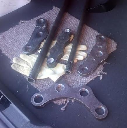

The hole saws did not do the job. I thought I would try it, but these things are junk.
Paid to get the holes drilled, but did not read the note re. the reaming to get the fork tubes to slide in.
I took a coarse sanding belt, wrapped it around a piece of 1 inch tube, and smoothed out the hole so the rear legs would fit.
Works good.

I'm surprised the hole saws didn't work out. I think maybe the reason might be that you used some 'good' steel for your trees. I think the saws are probably made of 4140 and you might have been sawing into some alloy that's a lot better that 1018/1020.
Yes the length of the neck can make a difference. You're running into the same problems I faced when trying to do a 'documentation' of building a springer and that is that there are dozens of variables involved, to many to really address in the typical Internet article. My intention was to provide a very 'broad' overview and unfortunately a lot of people took that as meaning that my way was the only way, which was not what I wanted. I think what really causes problems is that there really isn't such as thing as a 'standard' spring length. This has caused no end of problems for a lot of people who made the mistake of welding the perch in place before they bought springs. Anyway you're doing a great job and have thought through a lot of the typical problems so keep going.
