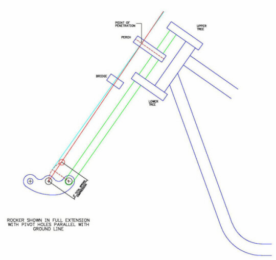

Re: Rocker angle
That last answer may be hard to follow so I made a simple sketch to illustrate the concept. Hope I can post it.
- ROCKER-GEO-1-Model.jpg (41.69 KiB) Viewed 458385 times

Re: Rocker angle
It worked. This is a simple way of doing the geometry for the pivot points that I was talking about. It has nothing to do with flop, trail, or axle placement. There are other ways of doing roughly the same thing but this method has stood the test of time, roughly 95 years and tens of thousands of springers since the first ones were introduced. It is probably not worth while trying to reinvent the wheel of fixing something that isn't broken. You can see that as the rocker moves thru it's full range of motion, from full compression to full extension, the sprung leg (shown in red) follows the arc of the rocker at the lower pivot point as it moves up and down. Ideally what you want is for the sprung leg to be perfectly parallel to the rear leg at two point in this up and down movement. One point is at full extension and the other is at full compression. Between these two points the sprung leg pivot point will arc out slightly which is normal. This is why the bushing for the spring rod at the perch is a very sloppy fit, sometimes a full .03" oversized. It allows room for the rod to move without binding for and aft.
This sketch is rocker at full extension. At rest the weight of the bike will cause the front end to settle somewhere between a half and three-quarters of an inch, maybe even a full inch on heavy cycles. When this occurs the angle between the rear pivot and front pivot will typically be around 20-degree from horizontal. This angle isn't magic but again history has shown that it works the best over the long term. I suspect the reason is because most forks spend about 80% of their time being compressed and only 20% of the time being fully extended. Therefore it seems logical for the spring preload created by that 20-degree change in angle at static load to be realistically needed.

Re: Rocker angle
Forgot to add. Keep in mind that the line between the front and rear pivot points is parallel to ground for a 'stock' springer. That is a fork having around a 30-degree rake angle. As the rake angle increases the line between the points will change proportionally to keep the pivot geometry correct. For instance for a 45-degree rake the angle between the front and rear points will be 15-degrees above horizontal (45-30) and so forth. You get the idea.
