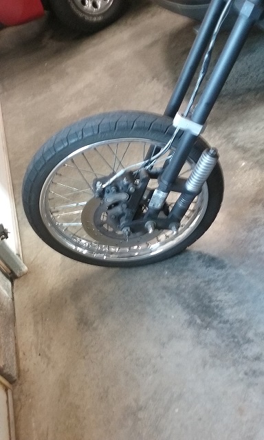

I was thinking of maybe changing the front end on my rigid and maybe building a springer from the plans here or something similar. I've had this bike 5 yrs, runs great rides good just a little stiff on steering because best I can measure the trail is about 8 1/4" and I'm always changing things on it so thought I might as well work on the front end too, I can always go back if I don't like it.
here's my bike, not sure of the exact dimensions best I can measure I think it's about 6" up 5" out, 45 deg rake with stock Deuce trees.

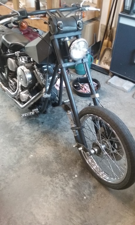

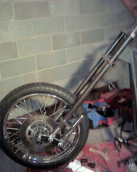

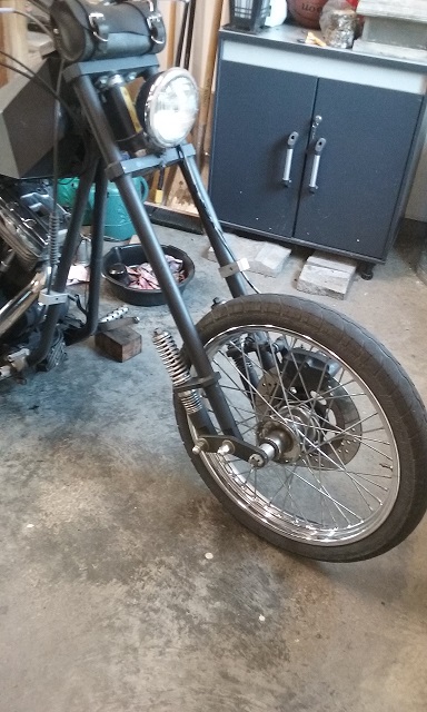

My inverted springer rides nice,I can ride with no hands and it tracks straight. I have about 4.5" of trail. I followed a set of plans and used springs called out on the plans. They were not stiff enough. What would happen is that if you steered the forks most of the way to either side, like parking lot maneuvers, the wheel would rock sideways a little due to the rockers moving independently of each other. I overcame this by using very stiff die springs instead. the only negative is that the rockers do not move very much unless you hit a very bad bump, so it is a very stiff ride. Another way to overcome the problem would be to have a bar, or someway to tie the spring rods together. (it could be used as a place to mount a fender if you want one)
While I am not unhappy with My inverted springer, If I was to build another, I would seriously consider using Gary's plans.

Thanks Jim Sawyer, I was thinking about that yesterday wondering how they would act independently, I'd just have t make it rigid enough but Imagine a stiff ride is probably normal for this kind of fork..
I'd like to see yours, got any pics ?

Re: idea to build springer to reduce trail a little
one pic while building using smaller springs, the rest are with the heavier springs

Curt, thanks I didn't notice your post till jun now for some reason. I'll search for krymis posts for some info. I've thought about making some raked trees too just a bit more money and time, but I might try it too.
Thanks for the pics Jim, very cool front end
