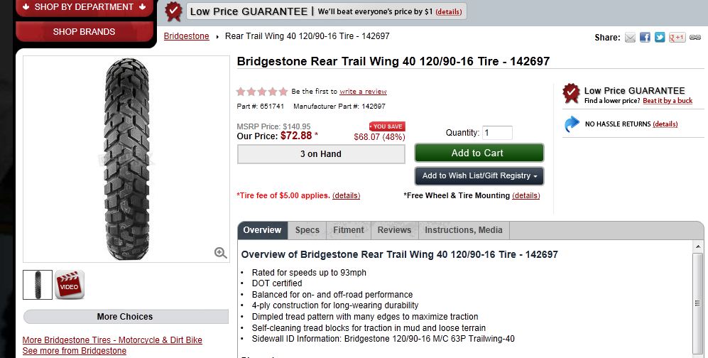

Re: modifying tire tread
DENNIS KIRK
DENNIS KIRK
https://www.denniskirk.com/help_center/tire-sizes.jsp
#142697

Also, I've always used radial tires, never any tubes. Did not cross my mind that maybe I could use a tube on a mag, never asked the question.
I've searched several tire stores, the trail wing does not get very good reviews.
There are some 16 in tires for dual sport, not many, most are 17 and up. The 16 in tires I've found so far do not thrill me, seem to be lacking in construction features,
sidewall plies, speed rating, on/off hiway usage rating, etc.
