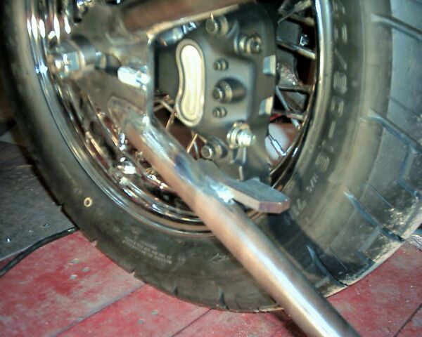

I figured out how to atatch a pic
- 2021.jpg (64.39 KiB) Viewed 29758 times
Re: Its about brakes.
Good install pic.
Looks like the stock Harley setup with the mounting bracket and caliper.
What year and model is that from?
The flatbar welded to the lower leg helps hold it in position.
Thanks.
Thanks.

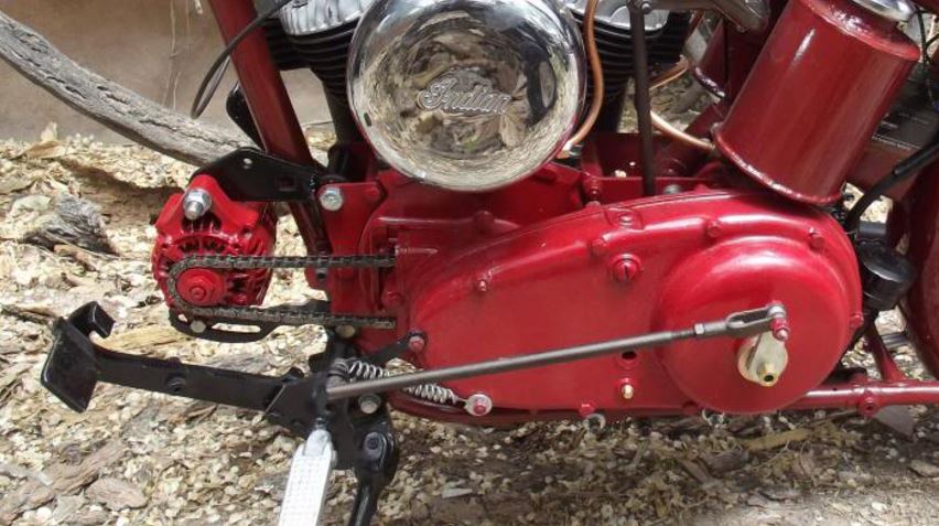

I like the alternator setup.

I am not sure what year the caliper is, It fits a 3/4" axle. I bought it from Robs used Harley parts.
Thanks for the help.Jim Sawyer wrote:I am not sure what year the caliper is, It fits a 3/4" axle. I bought it from Robs used Harley parts.
