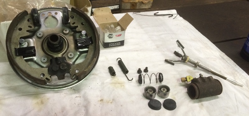

Put the tranny plate on the tranny and bolted it up, it all went fine until I tried to put that right side 5th bolt in, no go!
The slot in that right side frame bracket was just slightly too close to the left, so I had to file it on the right side,
and test fit about 3 times, finally it would bolt up....
