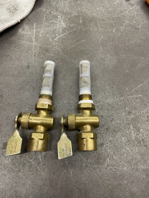

I wanted to put petcocks on that had filters in the tank instead of the inline filter i was using. Bought a couple but wasnt liking them so I turned a couple little pieces that press fit into the original petcocks & a snug push fit for the filter. The older brass ones are so much better looking than the ones I bought. Couple more small things to do & ill be taking it down the road.
i like the brass ones better too
ditto on the brass!

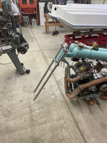

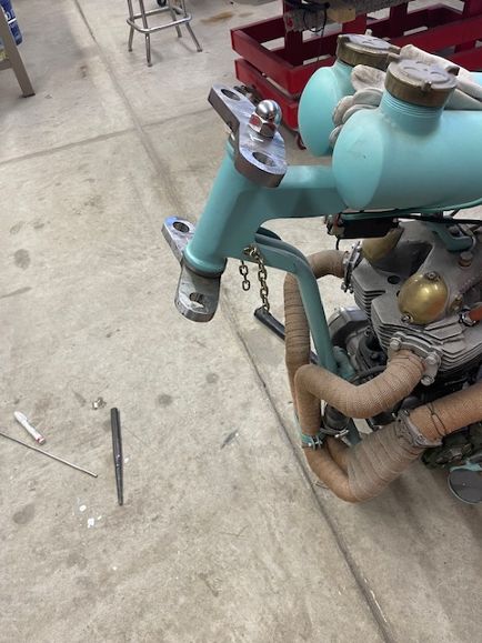

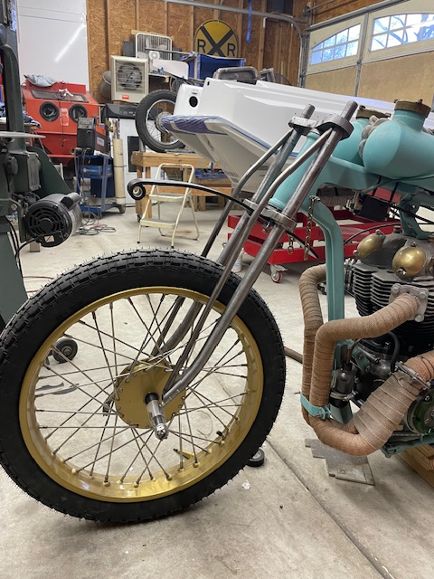

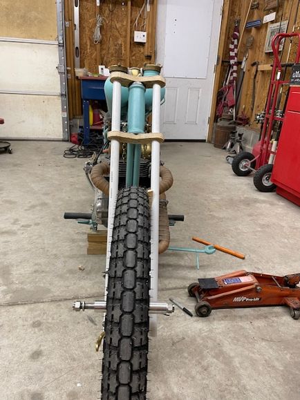

I decided to build another leafer for the bike. 1st mocked up some trees in wood to makesure everything was good. Then made then in steel & made a stem. bent up some legs. Waiting on bushings & trying to figure out bars.
Finally finished the front end. All fab work done & ready to tear down for powder.

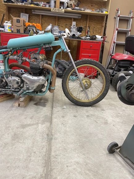

Back together & on the bike.

looks dam great! How does it ride?
Thanks man…bike ride great with the hydraulic front end, haven’t had it out yet with this one yet.
i like it
Love your build. How do you like the way it rides with the new leafer?
